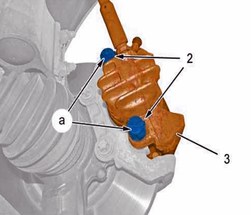

DS4 DV6FC Teves Assembly Front Disc Pad Replacement
Removing
Note: If the brake fluid reservoir is at maximum level, remove its filter and partially drain the reservoir with the aid of a clean syringe in order to avoid it overflowing.
Release the front wheel bolts.
Lift and support the vehicle with front wheels suspended.
Remove:
Refitting
Push the piston fully home in its housing using a FACOM D60A type clamp. Note:
Insert a shim between the FACOM D60A pliers and the brake pad in order to push the piston fully back into its housing.
Check the brake fluid level.
Refit:
(*) Always to be replaced whenever removed
Essential: Apply the brakes several times, gently and progressively, with the engine running, before driving the vehicle.
Check the brake fluid level and top up if necessary.
Removing
Remove:
- The front wheel bolts
The front wheels
| Remove the Spring shown at (1) | Remove:
Move aside and suspend the brake caliper (3). Remove the brake pads. |
Refitting
Refit:
- The brake pads
- The brake caliper (3)
- The brake caliper bolts (2)
- The plugs (at "a")
- The spring (1)

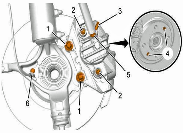

| Reference | Description | Tightening torques |
| (1) | Bolts (Front Brake Caliper Support) (*) | Pre-tighten to 9 daNm Angular Tightening of 45° |
| (2) | Bolts (Front Brake Caliper) | 2.7 daNm |
| (3) | Bleed Screw(s) | 1 daNm |
| (4) | Bolts (Front Brake Disc) | 1 daNm |
| (5) | Union (Hose / Front Brake caliper) | 2.2 daNm |
| (6) | Bolts (Front Wheel Sensor) | 0.8 daNm |

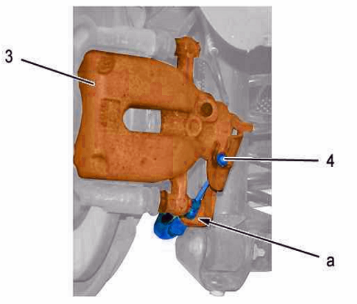

DS4 DV6FC Assembly Rear Disc Pad Replacement
Removing
Untighten the rear wheel bolts.

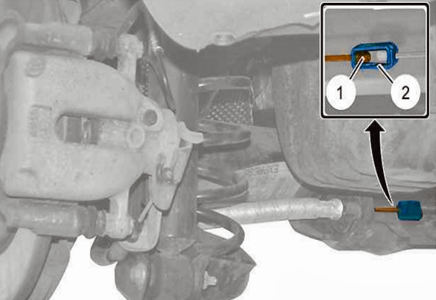

Slacken the parking brake Note - ensure you manually disengage the electric parking brake after the ignition is switched off (consult the manual). It is important that the handbrake is not re-engaged by the system when the ignition is switched off or you will not be able to release the cable from the yoke. It is then essential to disconnect the battery so there is no chance of accidentally turning the ignition on and the handbrake re-engaging!
Follow the BSI Reset / Battery Disconnect / Reconnect Procedure here before disconnecting the battery.
Note: For vehicles fitted with an electric handbrake, disconnect the battery.
Vehicles with Electric Handbrake
Refitting
Rear Brake Torques

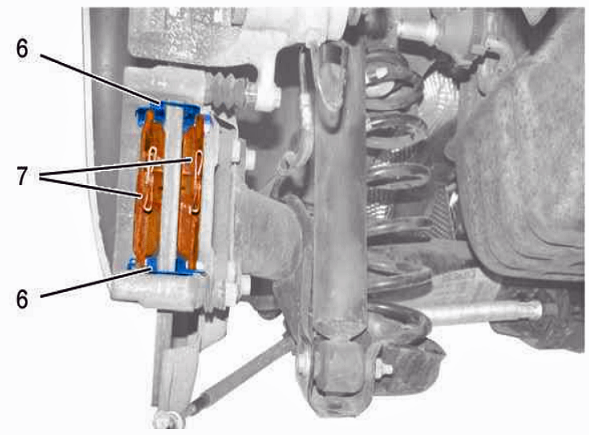

CAUTION: The sound-deadening pads (6) must be changed when you replace the brake pads (7).
Fit:
Caution: At each removal, systematically replace the bolts (5)
Refit bolt (5) (Apply a counter-torque (at "b")).
Clip the ring (at "a").
Engage the cable end piece (4) on the brake caliper (3).
Electronic Parking Brake
Engage the end piece of the cable (1) in the yoke (2).
Fit:
Caution: Apply the brakes several times, gently and progressively, with the engine running, before driving the vehicle.

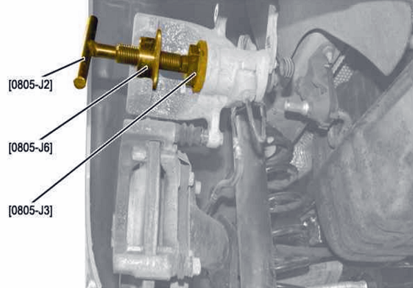

| Piston Wind Back Tool and Adaptor |

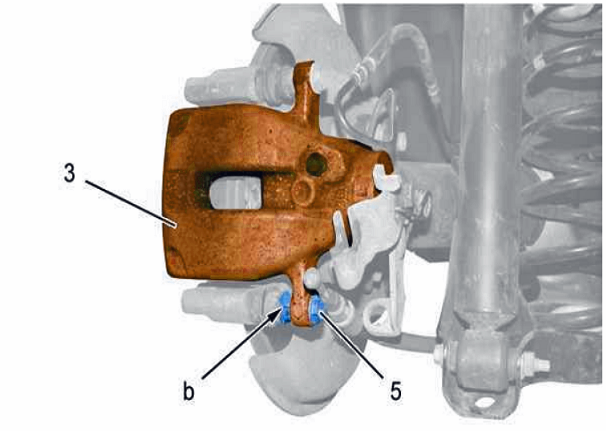

| Detach the end piece of the cable (1) from the yoke (2). | Detach the cable end piece (4) from the brake caliper (3). Press on the ring (at "a"). Release the cable from the brake caliper (3). |
| Remove the bolt (5) (Apply a counter-torque (at "b")). Tilt the brake caliper (3) upwards. Note: Do not open the braking circuit on the caliper. | Take down:

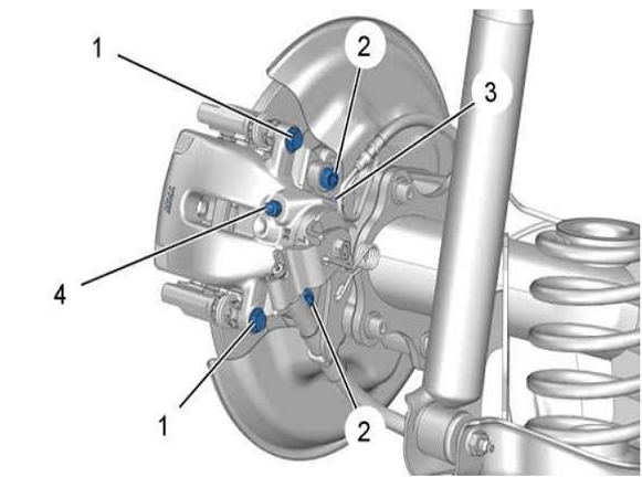

| (1) | bolts ( rear brake caliper) (*) | 3,5 daNm |
| (2) | bolts (Rear brake caliper support) (*) | Pre-tighten to 3 daNm;Angular tightening of 35° |
| (3) | Union (Hose / rear brake caliper) | 1,5 daNm |
| (4) | bleed screw(s) | 1 daNm |
| Turn and push back the piston of the brake caliper (3) (Clockwise) using the piston wind back tool. Watch the level of the brake fluid. |
Fit:
- The noise reduction shims (6)
The brake pads (7)
Fit:
- The rear wheels
- The rear wheel bolts
- Return the vehicle to its wheels.

Thanks for the info on rear brakes are the Pistons handed in the way you turn near side piston or off side piston Do you need left and right hand retractors. I haven't got diagbox so it will likely be Citroen job but info still appreciated John
- x 6958
Re: DS4 brake change
They are turned clockwise using the tool John in the table above, only on the rears.
