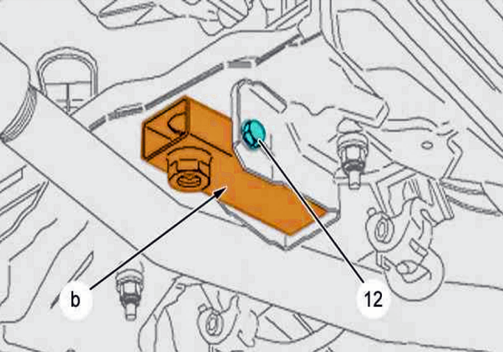

Re: Going to do my clutch C3 MK2 2011, tips?
Gearbox Removal / Refitting C3 (A51) Manual 5 Speed Box
Note: Always replace the 2 x Gearbox Centring Pins.
Official Tooling
Removing
CAUTION: The transmission is removed from under the vehicle.
Refitting
CAUTION: Adhere to the tightening torques.
CAUTION: Always replace the gearbox centring pins.
Check:
Protect the interior of the clutch housing from splashes of grease.
Apply the recommended grease uniformly on the stop guide and the input shaft.
Grease the fingers of the clutch fork.
N.B. : Use MOLYCOTE G-RAPID PLUS grease.
Remove the surplus grease on the top of the grooves and the end of the input shaft using a cloth.
CAUTION: An excess of grease will contaminate the clutch friction plate and cause noise in neutral, slipping or juddering of the clutch.
CAUTION: If the clutch disc is reused, the disc hub must be free of traces of oxidation.
N.B.: Check the presence of new gearbox centring pins.
Clean the bolt threads.
When refitting, the thrust must be on its guide and positioned by the throw-out fork.
CAUTION: Do not crush the starter motor electrical harness while refitting the gearbox.
Attach the gearbox to the engine.
Refit:
Refit the bolts (8).
Attach the gear engagement and selection cable sleeve stops (at "b").
N.B.:The sleeve stops are locked automatically on refitting. Check that the cable stops are locked correctly.
Couple up:
Couple up: The gearchange transfer rod ( as "c").
Refit the fixing: Earth lead (3).
Connect the connector ( as "a").
Reclip the ancillaries battery electrical harness sheathing (4).
Refit the ancillaries battery support .
Secure the electrical harnesses attaching to the service (ancillaries) battery tray .
Refit:
Reconnect the ancillaries battery.
Refit:
Initialise the various ECUs.
Remove the vehicle from the ramp.
Here endeth the lesson....
Official Tooling
0216-G2: Forks for Removing Gearbox Control Rods | 0012-Z: Lower Engine Support Crossmember "a" : Transverse engine support bar "b" : support "c" : Safety bolt "d" : Longitudinal engine support bar "e" : bolts "f" : engine support "g" : bolts "h" : bolts "j" : Pliers |
- Place the vehicle on a two-post ramp.
- Set the gearbox in neutral.
- Disconnect the ancillaries battery.

| Position:
Position the support "b" of tool [0012-Z] in place of the reaction link rod (13). Fit and tighten the bolt (12). | Position:
Remove the engine-gearbox coupling bolts (17). | Remove:
