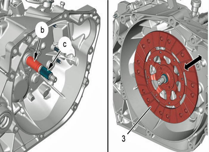

Greasing
CAUTION: Strictly observe the lubrication step.
CAUTION: Protect the interior of the clutch housing from splashes of grease.
Vehicles equipped with a gearbox that has a mechanical clutch bearing:
Spray a little grease MOLYCOTE G-RAPID PLUS (aerosol) on the splines
of the primary shaft and on the clutch bearing guide tube (at "b" and "c").
Vehicles equipped with a gearbox that has a hydraulic clutch bearing:
Grease the splines of the primary shaft with
MOLYCOTE G-RAPID PLUS (at "c").

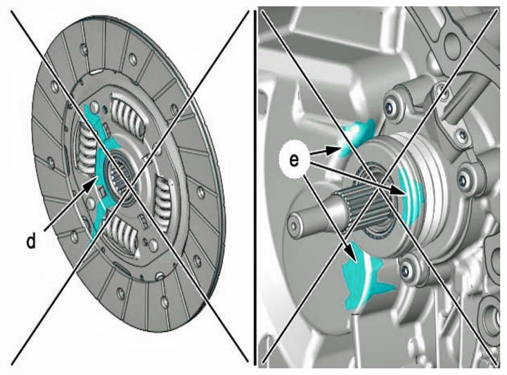

CAUTION: Do not soil the clutch disc lining - Risk of skating.
Establish the clutch disk (3) on the spline shaft and perform multiple translations to distribute the grease.
Remove the clutch disc.
CAUTION: An excess of grease will contaminate the clutch friction
plate and cause noise in neutral, slipping or juddering of the clutch.
"d": Traces of grease present on a clutch disc polluted due to excess grease.
"e": Traces of grease present on a clutch housing polluted due to excess grease.
CAUTION: Clean any grease that may be projected onto the rotating friction.
Remove the surplus grease on the top of the grooves and the end of the input shaft using a cloth.
Note: The film of grease deposited on the rotating elements must
be as thin as possible to avoid splashing.

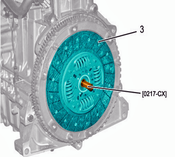

Refit the clutch disc (3).
Centre the clutch disc (3) using tool [0217-CX].
CAUTION: The clutch mechanism and disc are paired
at the factory and cannot be replaced separately.
CAUTION: Any fitting of a clutch mechanism with automatic free
play adjustment (whether new or re-used) must compulsorily be performed
using the compression tool [0217].
Refit the clutch mechanism (2).
N.B.: Do not remove the tool [0217-CX].

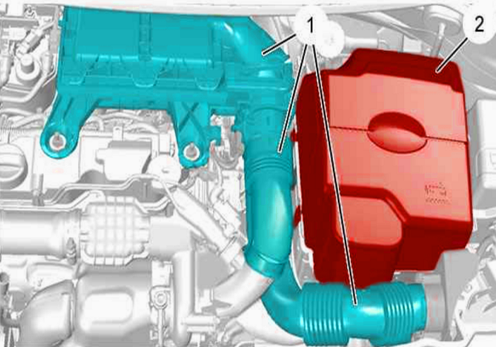

Remove:
  • The air inlets and resonator (1)
  • The engine management ECU
  • The ancillaries battery cover (2)
  • The service battery

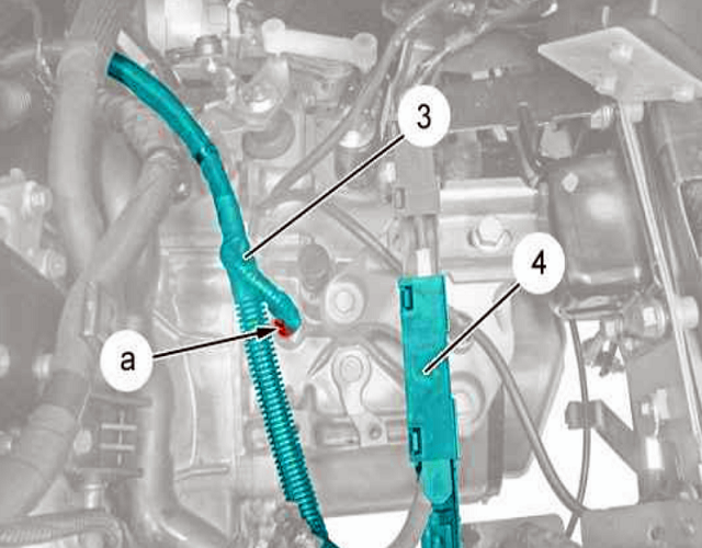

Release and move aside the electrical harnesses attached to the service battery tray.
Remove the ancillaries battery support.
Unclip and move aside the ancillaries
battery electrical harness sheathing (4).
Disconnect the connector (at "a").
Remove the earth wire (3).

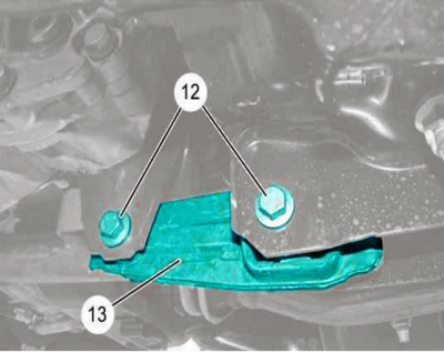

Remove:
  • The bolts (12)
  • The reaction link (13)

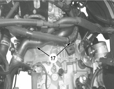

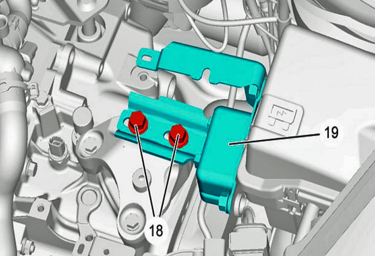

Remove the engine-gearbox coupling bolts (17).Remove:
  • The 2 bolts (18)
  • The gearbox
  • The bracket (19)

Check:
  • That there is no leak at the crankshaft seal
  • There are no oil leaks at the stop guide
  • The state of wear of the clutch
  • The state of wear of the declutch bearing
CAUTION: Clean the input shaft completely along its entire length, over its entire periphery and in the grooves.
Apply the recommended grease uniformly on the stop guide and the input shaft.
Grease the fingers of the clutch fork.
N.B. : Use MOLYCOTE G-RAPID PLUS grease.
CAUTION: An excess of grease will contaminate the clutch friction plate and cause noise in neutral, slipping or juddering of the clutch.
CAUTION: If the clutch disc is reused, the disc hub must be free of traces of oxidation.
N.B.: Check the presence of new gearbox centring pins.
Clean the bolt threads.
When refitting, the thrust must be on its guide and positioned by the throw-out fork.

Refit:
  • The engine-gearbox coupling bolts (17)
  • The (16) bolt
  • The stud (15)
  • The nut (14)
  • The bracket (19)
  • The 2 bolts (18)

Refit:
  • The bolts (12)
  • The stabiliser bar (10)
  • The bolts (11)

Position: The gearchange transfer earth (7).
Couple up: The gearchange transfer rod ( as "c").
Refit the fixing: Earth lead (3).
Connect the connector ( as "a").
Reclip the ancillaries battery electrical harness sheathing (4).
Refit the ancillaries battery support .
Secure the electrical harnesses attaching to the service (ancillaries) battery tray .

Amazing, thank you @GiveMeABreak !!
Could someone explain the special tool for pressure plate removal? ive never seen a special tool for removing a clutch assembly and ive always seen people use a universal alignment too for refitting, which i have. Is this one of those things only dealers do? or are some clutches "special"?
TIA!
x 6945
Re: Going to do my clutch C3 MK2 2011, tips?
No worries.
The tool's function is to improve the centering of the friction plate and to eliminate engine jerks, vibrations and noise, by compressing the clutch mechanism when tightening the fixing bolts.
PSA have the main tool and there is a different part ([Cx]) with the centring drift 'x' varying according to engine. They use this across the range of PSA engines when doing the clutch.
