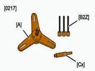

Procedure for Removal and Refitting Clutch on a C3 (A51)
Tools:
Removing
Pre-requisite - remove the gearbox See the procedure a few posts down:
Gearbox Removal
CAUTION: Some flywheels have through threads.
Do not allow the threads of the 3 retaining rods to protrude when screwing -
Risk of deformation of the secondary flywheel.
Screw in the 3 retaining rods [0217-B2Z] in place of the fixing screws (1). Do not allow the threads to protrude.
CAUTION: When compressing the clutch mechanism, do not cross a
hard point when tightening the central screw of the tool [0217-A].
The tightening must not exceed 10 turns clockwise.
Compress the clutch mechanism (2) with the central bolt of tool [0217-A] (at "a").
Finish removing the remaining bolts (1).
Release the clutch mechanism (2) by moving the central bolt of the tool [0217-A] (at "a").
Remove tools [0217-A] and [0217-B2Z].

Torque Settings - Clutch
Tools:
0217: Clutch Mechanism Compression Tool 0217-A: Clutch Mechanism Compressor 0217-B2Z: Retaining Rod (∅ 8mm) 0217-Cx*: Clutch Centring Drift Note: The exact centring drift will vary with engine type. In this case 0217-C6Z is the correct one for the DV4C engine that the member has. |
Gearbox Removal
Fit the tool [0217-CX]. | Remove the 3 bolts (1) (Every second bolt). Position the tools [0217-A] and [0217-B2Z] on the clutch mechanism (2). |
Remove:

CAUTION : Observe the tightening torque values.
CAUTION: When refitting, place the face of the clutch disc, where the N° PSA 96 XXX XXX 80 is marked, gearbox end. Refit the clutch disc (3). Centre the clutch disc (3) using tool [0217-CX]. | CAUTION: The clutch mechanism and disc are paired at the factory and cannot be replaced separately. CAUTION: Any fitting of a clutch mechanism with automatic free play adjustment (whether new or re-used) must compulsorily be performed using the compression tool [0217]. Refit the clutch mechanism (2). N.B.: Do not remove the tool [0217-CX]. |
CAUTION : No resetting of the clutch wear adjustment is permitted. Position the tools [0217-A] and [0217-B2Z] on the clutch mechanism (2). Screw in the 3 retaining rods [0217-B2Z] in place of the fixing screws (1) Do not allow the threads to protrude. Tighten the 3 bolts (1) by hand. |
Gradually compress the clutch mechanism (2) until it contacts the primary flywheel (at "f"). Check the absence of friction:
ighten the central screw of the tool [0217-B2Z] by a maximum of two additional turns.
Tighten the 3 bolts (1) to the specified torque.
Unscrew the center bolt of the tool [0217-A] (at "a") by several turns to detension the clutch mechanism (2).
Remove tools [0217-A], [0217-B2Z] and [0217-CX].
Refit and tighten the remaining 3 bolts (1).
Refit the gearbox.
(1) Clutch friction plate. (2) Clutch mechanism. (3) Clutch mechanism fixing screws (2).

Could someone explain the special tool for pressure plate removal? ive never seen a special tool for removing a clutch assembly and ive always seen people use a universal alignment too for refitting, which i have. Is this one of those things only dealers do? or are some clutches "special"?

The tool's function is to improve the centering of the friction plate and to eliminate engine jerks, vibrations and noise, by compressing the clutch mechanism when tightening the fixing bolts.
PSA have the main tool and there is a different part ([Cx]) with the centring drift 'x' varying according to engine. They use this across the range of PSA engines when doing the clutch.

Thanks for that m8! Good info! Is it mandatory to do the job? Or will i get similar result with a universal alignment tool?
I have this one https://www.ebay.co.uk/itm/UNIVERSAL-CL ... SwQodZb3jZ

All I can see is that they designed it for a purpose, so it must be to both aid alignment (which other tools can do as you have found, but also to eliminate issues like juddering as described). I'm sure there are garages that don't use this sort of thing - so difficult to compare - but I would suspect it is to avoid the issue in the first place as a result of fitting.
