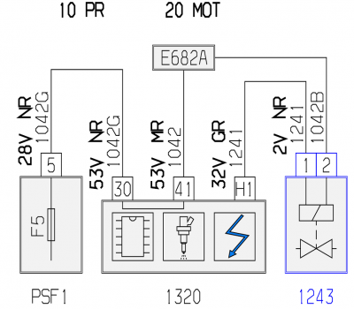

Here's the diagram for your 207 5 DOOR SALOON 1.6 VTi 16V 120 (EP6):
Hardware
1320: Engine ECU / Injector Supply
1107: variable valve position sensor
Wiring:
1452: sensor input VVT1
1453: vvt1 sensor output
1458: VVT sensor earth
1456: VVT sensor supply
1457: VVT sensor clock
1454: sensor input VVT2
1455: vvt2 sensor output
412: Oil pressure signal
Hardware
Wiring:

Re: 207 problems
No worries, I hope this helps track the issue.
Re: 207 problems
yes but with out knowing wire colours or rest ofdiagram instructions im a bit snookered im not an auto electrician just an old guy who likes messing

Re: 207 problems
PSA wiring does not primarily use colours for identification. You will see numbers (often 4 digit) on the diagram, these same numbers are printed on the wires every few cm.
Marc, what are the component code numbers of the VVT solenoids?

Re: 207 problems
1243: variable timing electrovalve 1
1268: variable timing electrovalve 2
Re: 207 problems
thats brilliant marc once again im in your debt ,now if i can find my glasses i can have a mess
thanks again graham
