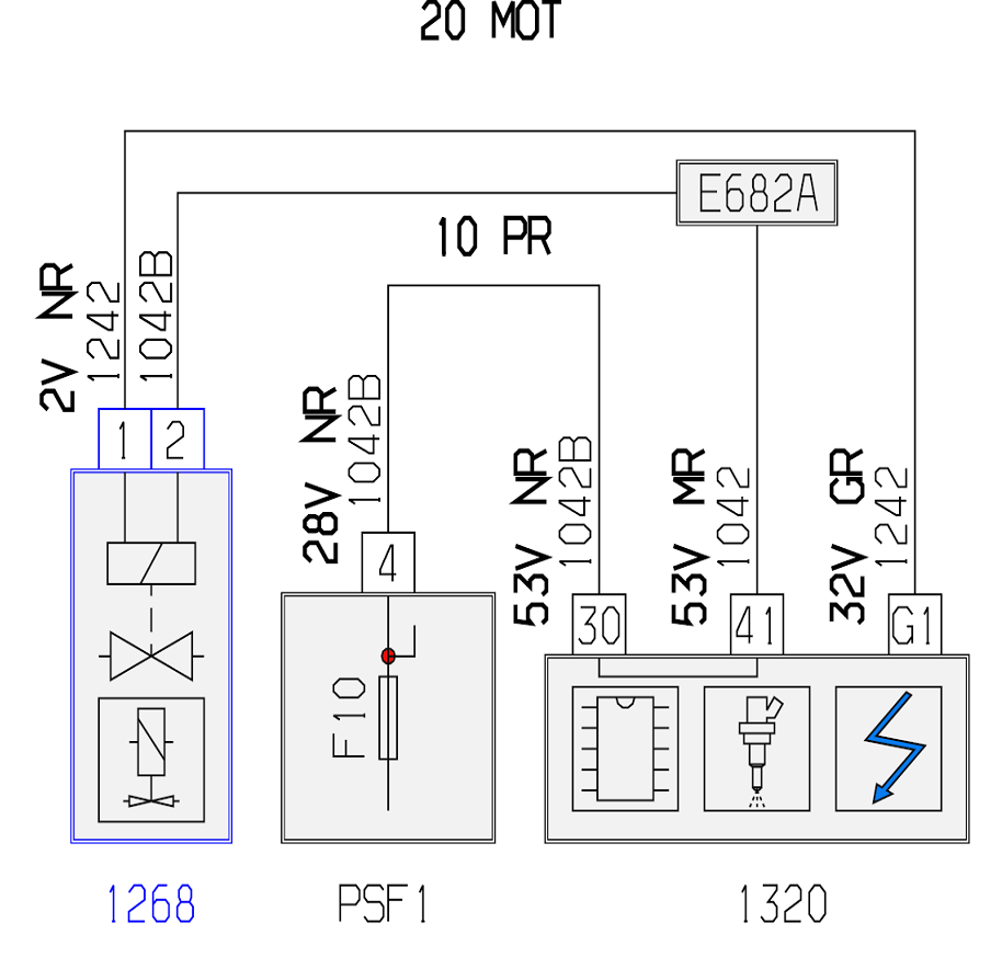

Re: 207 problems
Post by GiveMeABreak »
Here's the diagram for your 207 5 DOOR SALOON 1.6 VTi 16V 120 (EP6):
Hardware
1320: Engine ECU / Injector Supply
1107: variable valve position sensor
Wiring:
1452: sensor input VVT1
1453: vvt1 sensor output
1458: VVT sensor earth
1456: VVT sensor supply
1457: VVT sensor clock
1454: sensor input VVT2
1455: vvt2 sensor output
412: Oil pressure signal

Re: 207 problems
Post by vmaxer »
yes but with out knowing wire colours or rest ofdiagram instructions im a bit snookered im not an auto electrician just an old guy who likes messing
Posts: 9052
Joined: 09 Nov 2005, 22:03
Location: France or NewZealand
Lexia Available: Yes
My Cars: -
1997 Citroen Xantia V6 (France)
1999 Citroen XM V6 ES9 (France)
2011 Peugeot 308 CC THP 155 (NZ)
1975 Jaguar XJ-S pre-HE (NZ)
x 825
Re: 207 problems
Post by xantia_v6 »
PSA wiring does not primarily use colours for identification. You will see numbers (often 4 digit) on the diagram, these same numbers are printed on the wires every few cm.
Marc, what are the component code numbers of the VVT solenoids?

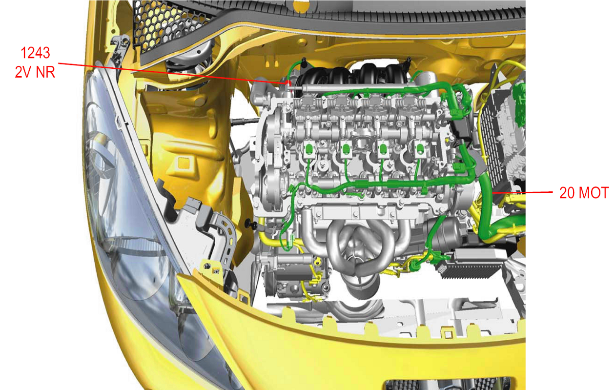

1243: variable timing electrovalve 1
1268: variable timing electrovalve 2

Re: 207 problems
Post by vmaxer »
thats brilliant marc once again im in your debt ,now if i can find my glasses i can have a mess
thanks again graham
