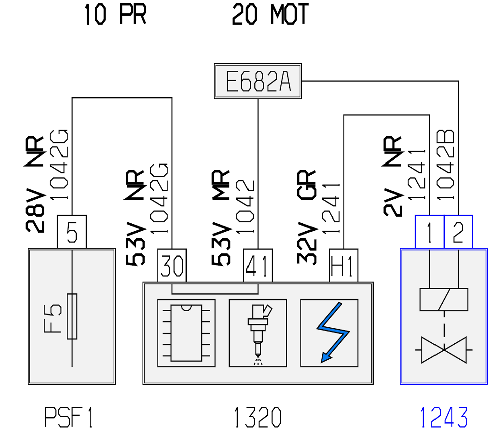

x 6957
Re: 207 problems
Here's the diagram for your 207 5 DOOR SALOON 1.6 VTi 16V 120 (EP6):
Hardware
1320: Engine ECU / Injector Supply
1107: variable valve position sensor
Wiring:
1452: sensor input VVT1
1453: vvt1 sensor output
1458: VVT sensor earth
1456: VVT sensor supply
1457: VVT sensor clock
1454: sensor input VVT2
1455: vvt2 sensor output
412: Oil pressure signal

Re: 207 problems
Unread post by vmaxer »
yes but with out knowing wire colours or rest ofdiagram instructions im a bit snookered im not an auto electrician just an old guy who likes messing
Posts: 10958
Joined: 09 Nov 2005, 22:03
x 1456
Re: 207 problems
Unread post by xantia_v6 »
PSA wiring does not primarily use colours for identification. You will see numbers (often 4 digit) on the diagram, these same numbers are printed on the wires every few cm.
Marc, what are the component code numbers of the VVT solenoids?

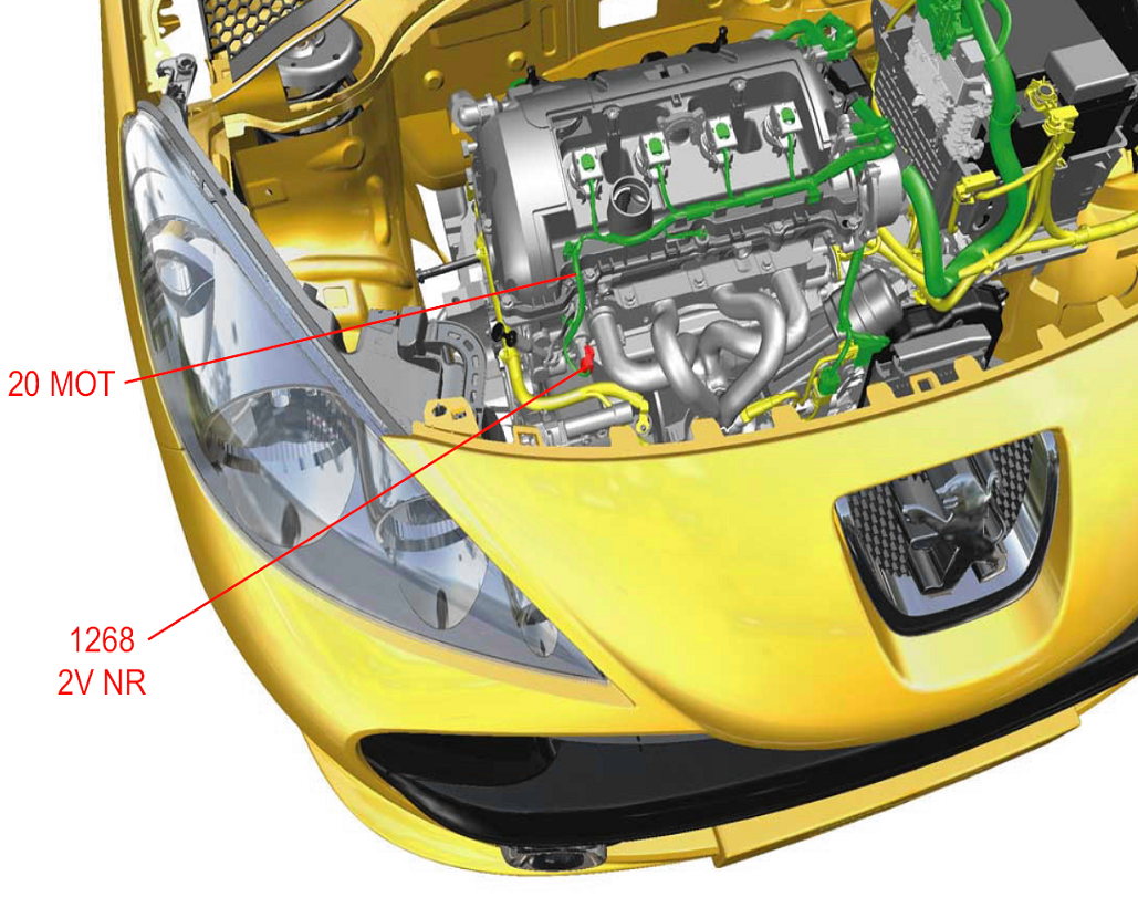

x 6957
Re: 207 problems
1243: variable timing electrovalve 1
1268: variable timing electrovalve 2
