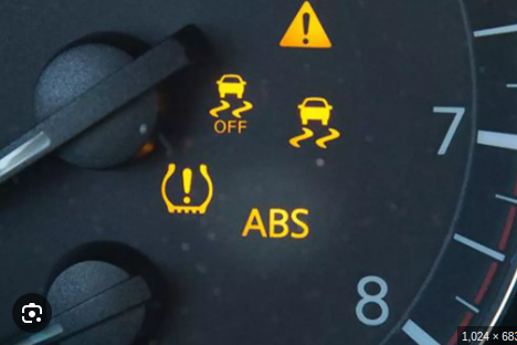

If it has ABS then there should be an indicator light up when the ignition is turned on, should then go out after a few seconds if the system self-tests as being functional.

The ABS module can be seen way down the bottom of the vehicle, under the near side headlight. The 6 brake lines can clearly be seen coming out of the hydraulic block. There is also a vinyl bag over the electrical connector. If it's not there, then you don't have ABS.
I have seen unscrupulous people blank out warning lights on instrument clusters so that the light never comes on (well it cant be seen).
