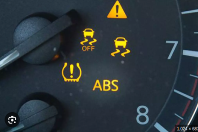

Does it have ABS? As the linked thread explains, ABS & ESP are quite tricky to bleed properly, but it's obviously essential to get it right.
Another related issue - apparently ABS blocks can leak internally, giving symptoms similar to what you are describing.

Re: C3 (2004) - Brakes "sinking pedal" feeling - new master cylinder?
I don't think it has ABS, based on the fact that when I emergency brake, the wheels lock up :') Straight after an emergency brake test, the brakes are almost useless for about 10-30 seconds - i.e. I can press the pedal almost to the floor with very little resistance.
So, with the engine on, pressing the brake pedal is easy at first and I can hear air moving somewhere in front of the passenger side dash. It sounds like a hand pump/air moving between chambers in a suspension system (brake servo perhaps? although the noise doesn't sound like its coming from directly in front of the pedals which is where I asssumed the servo is). Once the pedal gets to about 50% it stiffens up a bit and the brakes engage. This is pretty consistent so when driving its at least predictable. Once stationary, the brake pedal slowly sinks further but the brakes are still engaged.
With the engine off, at first there is the same easy-press until 50% and moving air noise, but with each press the system increases pressure and eventually there is no air-moving noise and the pedal has resistance from the top.
- Posts: 28677
- x 5673
If it has ABS then there should be an indicator light up when the ignition is turned on, should then go out after a few seconds if the system self-tests as being functional.

The ABS module can be seen way down the bottom of the vehicle, under the near side headlight. The 6 brake lines can clearly be seen coming out of the hydraulic block. There is also a vinyl bag over the electrical connector. If it's not there, then you don't have ABS.
I have seen unscrupulous people blank out warning lights on instrument clusters so that the light never comes on (well it cant be seen).
