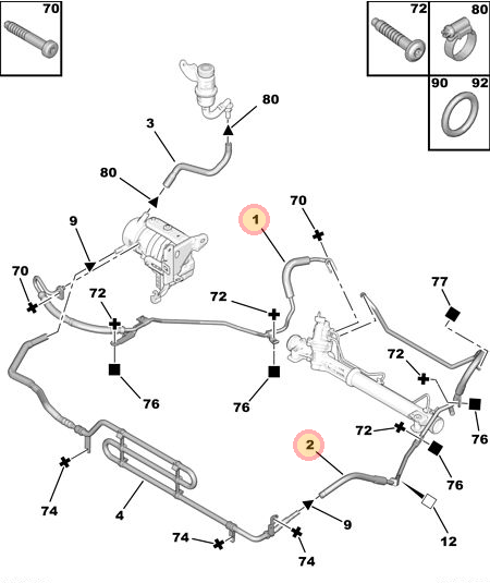

Hi all
I have a citro?n c5 iii estate (rw) 2.0 hdi 165 163 hp diesel rhh (dw10cted4) - as determined by numerous parts sites on entering my car reigistration.
I'm in need of a power steering pipe - part number 4014NV which I am advised is no longer manufactured. (I also need part number 4012V3 but this, apparently, is available from the dealers).
I'm asking on here if anyone knows of
a) any sites in the UK or otherwise which might be able to supply obsolete items or
b) any sites which might have manuals, photographs or illustrations of the relevant power steering set-up so I can at least get an idea of what the pipe I need looks like?
My VIN number is VF7**************[VIN obfuscated, can be read by forum staff]
(Citroen are miffing me off a bit with what you might call their planned obsolescence. I had to dump my last car, (mk2 C5), because the suspension pipes were not available.)
Thanking any respondents in anticipation

x 6957
Re: citro?n c5 iii estate (rw) 2.0 hdi power steering pipes
Hi Colin, here is the diagram showing said pipes:
(1) Steering High Pressure Pipe, part: 4014NV is marked as no longer available as you say.
(2) Steering Low Pressure Pipe, part: 4012V3 is available from Citroen, £109.19 inc. VAT.
Chevronics did have them used, but are out of stock:
https://www.chevronics.co.uk/product/c5 ... no-4014nv/
