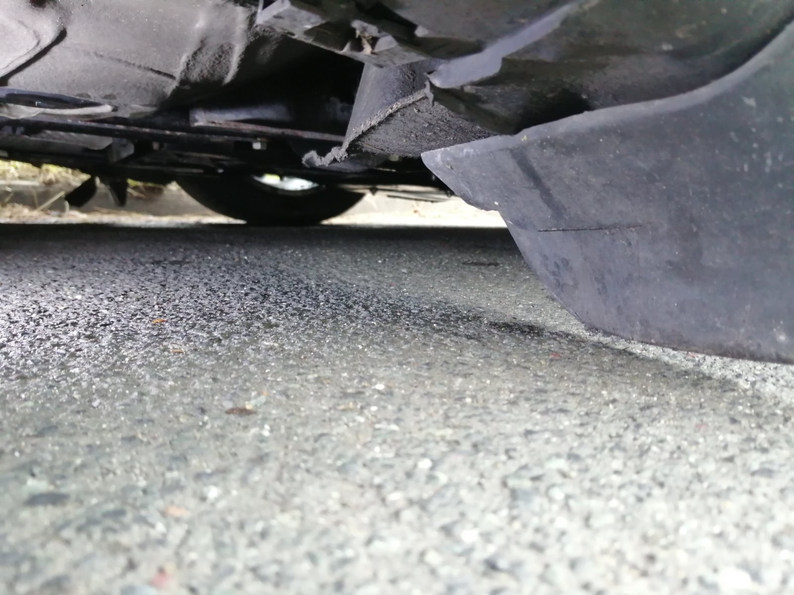

We were dashing out last night to a do and when I pulled away the X7 was down low making scraping noises on the road. I turned around and noticed two oil puddles so It's not the first time. No time to do anything except take the other car so I'm really looking forward to this weekend.

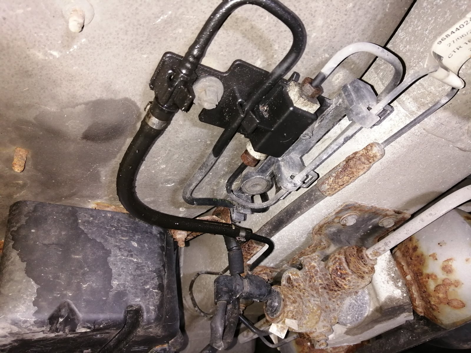

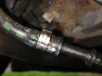

Looking underneath the car under the rack pinion shows it to be surprisingly dry on the road.
And looking at the pinion from inside the car doesn't show any sign of leakage. Whoohoo, Schrödinger's pinion can go back to its state of unknowing now.

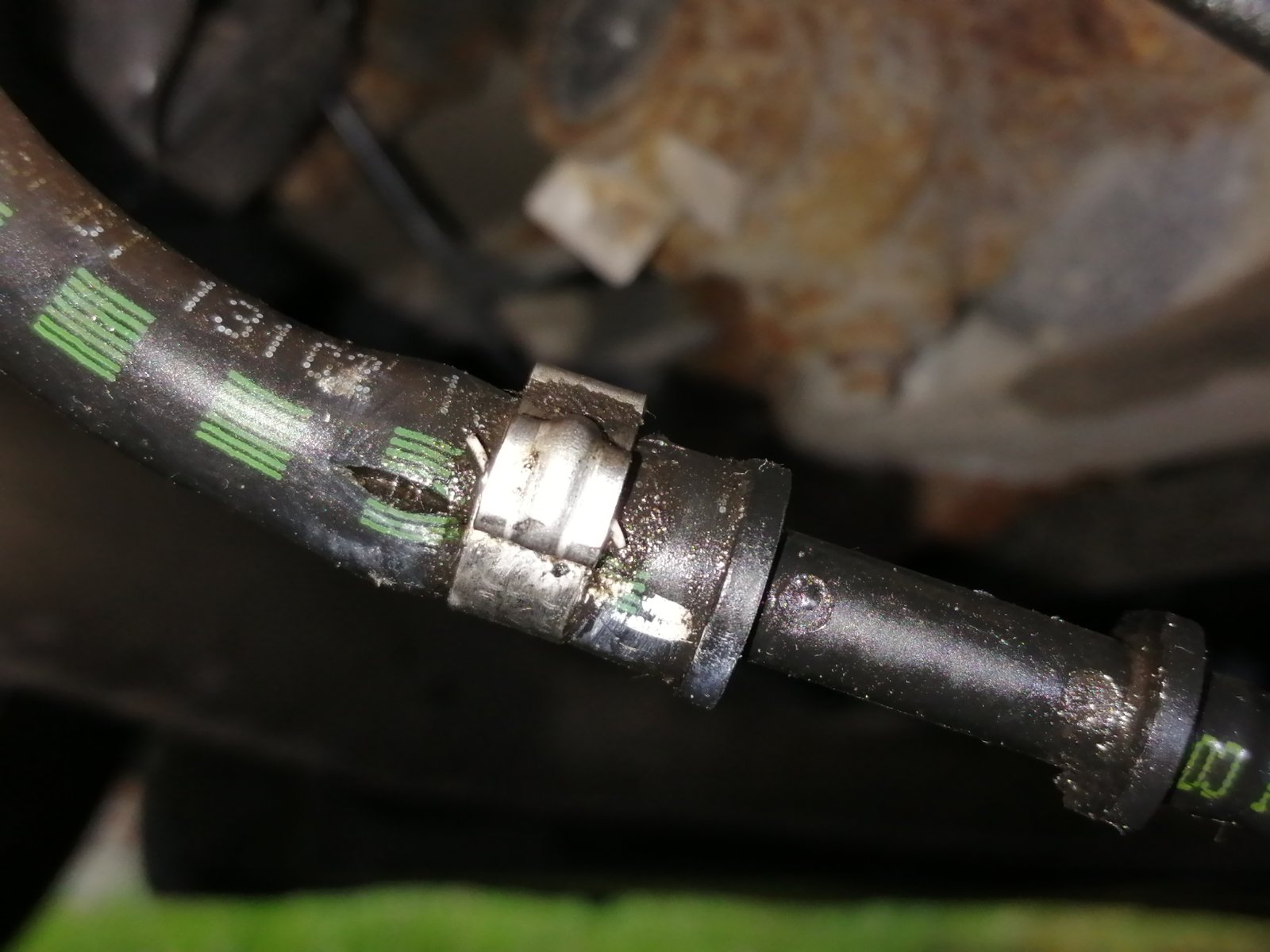

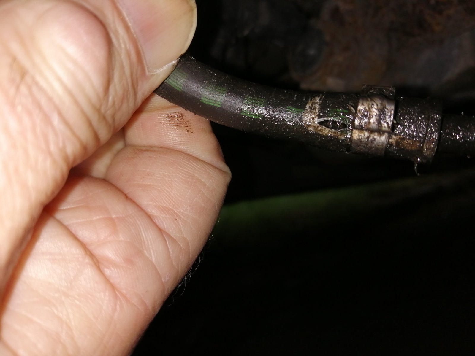

Looking under the rear of the car there's a bit of lubrication on the road and a lot of oily wetness to be seen.
Closing in this looks suitably guilty.
Yup, reckon that's it.
I guess this is on the return circuit so not under huge pressure. @GiveMeABreak Marc - Is that split hose still an available part? Although I actually think I could snip the split bit off and simply remake the connection. There's a lip on the end of the hose which would be lost but I doubt that's critical.
Looks like it should be an easy job. I reckon I could get it done while Thought for the Day is on the Today programme!

Yes, it's definitely looks a good candidate for the leak and hopefully also an easy fix - fingers crossed!

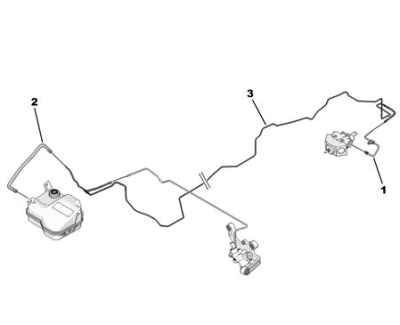

If it's the return harness pipes shown below, all those shown are available Paul:Paul-R wrote: 16 Sep 2023, 20:46 I guess this is on the return circuit so not under huge pressure. @GiveMeABreak Marc - Is that split hose still an available part? Although I actually think I could snip the split bit off and simply remake the connection. There's a lip on the end of the hose which would be lost but I doubt that's critical.
(1) Hydraulic Fluid Return Harness, part: 5270SE, £46.60
(3) Hydraulic Fluid Return Harness, part: 5270WR, £169.30

Flip, I don't need all that! And the price!! Thanks for looking though.

Hose repaired and after the ritual spilling of blood I managed to get the single use metal clip back on. It took 3l of LDS although I may have overfilled a bit as the car is not on its lowest ride height.
