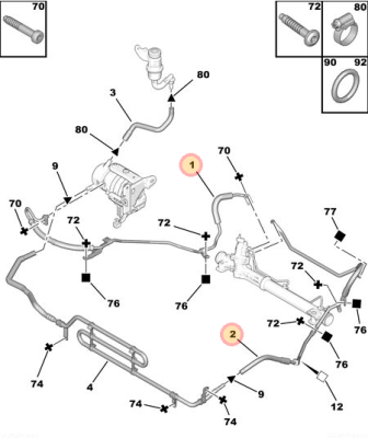

Hi Colin, here is the diagram showing said pipes:
(1) Steering High Pressure Pipe, part: 4014NV is marked as no longer available as you say.
(2) Steering Low Pressure Pipe, part: 4012V3 is available from Citroen, £109.19 inc. VAT.
Chevronics did have them used, but are out of stock:
https://www.chevronics.co.uk/product/c5 ... no-4014nv/
