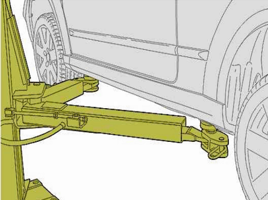

The vehicle must only be lifted at the stated jacking points shown in the vehicle-specific manual (this is an example only and not necessarily for this 3008).
Take it back to them and I'd be getting them to pay for any damage caused, as something certainly isn't right.
EditThis vehicle has a multi-link suspension system at the rear so the question is have they jacked it up on something they should not have and damaged any components?

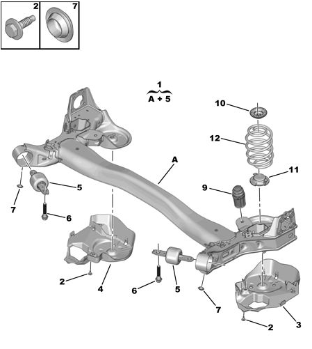

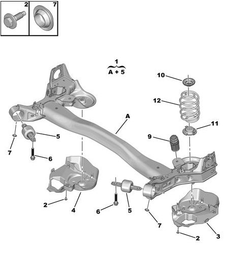

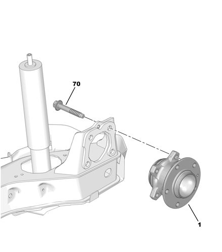

Ok, so wasn't sure I had the VIN for this particular 3008 - can you confirm it is the VIN ending 8805 and I'll check as I think this may have a different setup?
If it is then you have the following rear axle setup, so ignore the multi-link suspension info I posted above, that's for a different model and I'll remove that shortly.
Rear HubRear Axle
As for lifting, again the vehicle should only be raised at the official; jacking points.

GiveMeABreak wrote: 13 Jul 2023, 10:59 Ok, so wasn't sure I had the VIN for this particular 3008 - can you confirm it is the VIN ending 8805 and I'll check as I think this may have a different setup?
Rear HubRear Axle
Any chance there is a part number for item 9 in the diagram above please? Or if generic how is it mounted? Just failed a car test because one of mine is missing :/

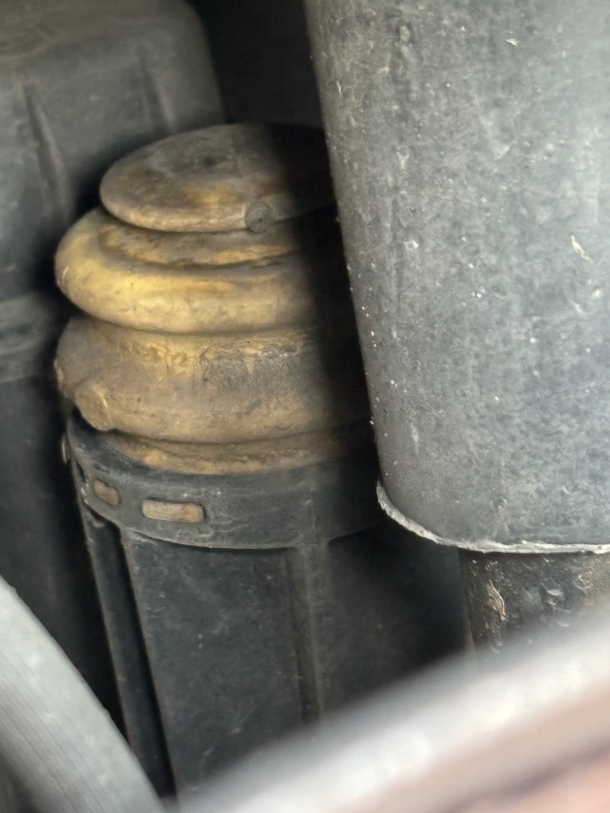

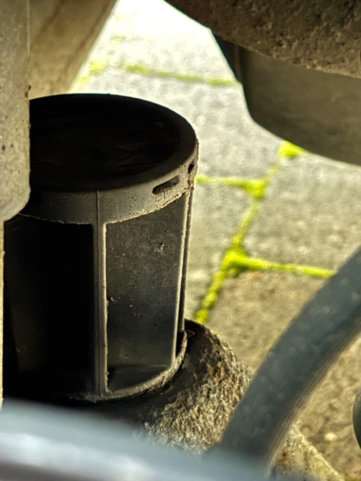

I also got a pic of the remaining one (OSR)
Will add shortly am on mobile need to read up on uploads
Jonsredpug
Posts: 11
Joined: 01 Nov 2024, 22:36
Re: 2017 3008 Rear Suspension Noise
Unread post by Jonsredpug »
Remaining stop OSR
Remaining stop OSR

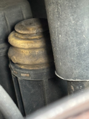

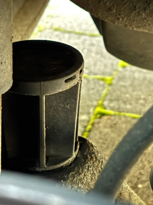

The extension is still there but the yellow rubber has buggered off: NSR
