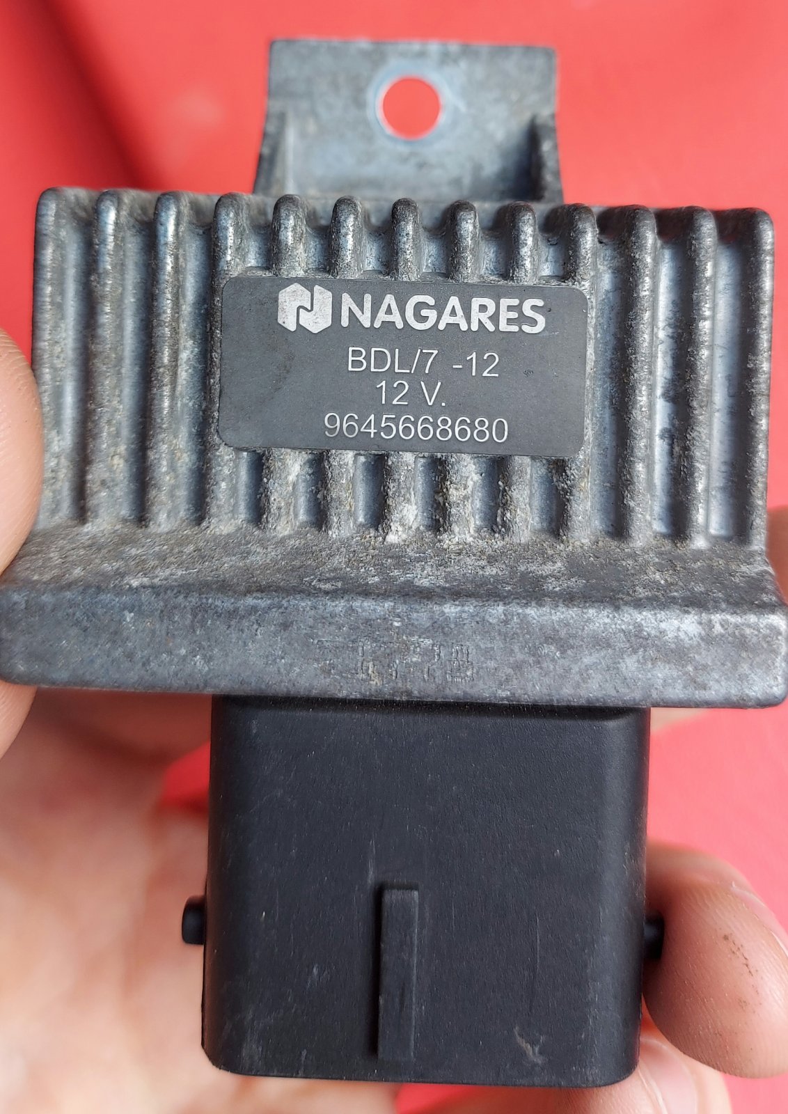

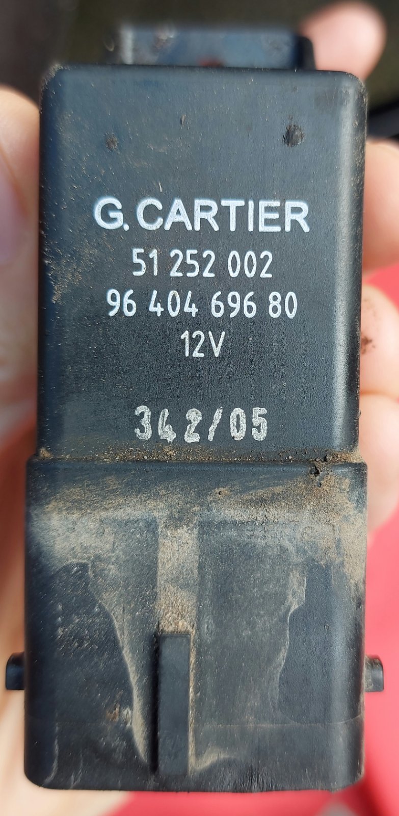

Hi so this is a follow up.
I purchased a replacement glow plug relay (number matching the above - 9645668680), and after the fiddly mess it is to actually get to the relay, I unplugged the one already attached.
The one that was already plugged in does not match the above number. Instead it's 9640469680.
For now I've just put it back, but I have no idea what to do. Is the part that is in already the wrong part, and the possible cause of my ABS light coming on (but with no error codes), or even after giving my VIN is the part number I was given wrong (I'm inclined to believe that's the unlikely one of the two)?

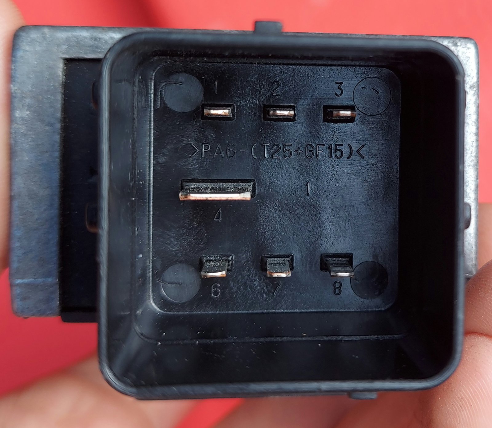

Also the part that is in has two large pins, while the new part matching the part number has only one large pin.
I'm going to attach pictures of both.
Thanks!
New matching # relay
Current relay
Current relay
Current relay
Current relay
x 6945
Re: C2 1.4 HDi '06 ABS Pump - "Is this correct" check?
Hi
So the 9645668680 part number is a replacement part for the originally fitted Glow Plug Relay. In other words 9645668680 is the superseded part number.
Your original Cartier relay (9640469680) was the correct original relay, (Citroen part: 598140), but it's been replaced with the new one. So nothing to worry about on that front.
