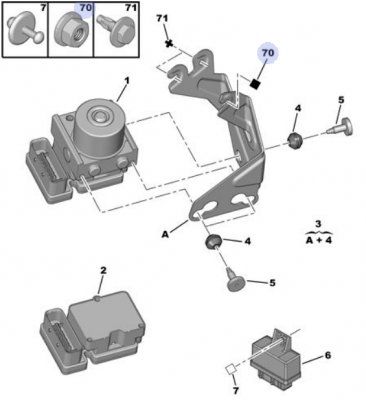

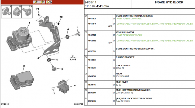

Right, to start off with these are 2 separate parts there is the hydraulic block and then there is the ECU - they are available separately, but neither still available from Citroen.
The block is item 1 and the ECU item 2 - part numbers to help with a search are shown in the table. Using these you should be able to locate a second hand one.
Click to Zoom
If fitting a second hand unit - make sure you match the numbers on the old one - if keeping your old ECU you should be fine with coding.

Ok, so in the diagram, item 1 is the ABS Hydraulic Block and item 2 is the ECU.
It is always better to keep your own ECU to avoid coding, otherwise you will have to configure / reconfigure the replacement with the specific options on your car using Lexia.
The breaker may have the complete module and probably won't bother separating these.
| Part number for the ABS Hydraulic Block: 4541FX Part number for the ABS ECU: 4542N1 These are PSA part numbers. |

Re: ABS Pump Part Number
You have the MK 70 version of the ABS Block - so there are 3 bolts to undo as shown on the diagram.
| Always follow the battery disconnection and reconnection procedure before replacing and after refitting. When refitting, tighten the bolts (2) to 0,24 ± 0,04 m.daN. |

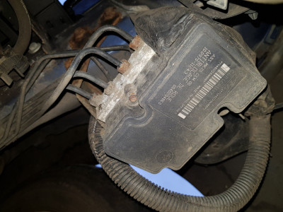

I've also today managed to snap a photo of the control unit on my car see attached. I noticed the numbers are different but would the Hydraulic Block be the same?

Ok, no worries - the ECU is slightly different - but if you are going to reuse you own ECU, that won't be an issue as you will just be replacing the hydraulic block, and that is the correct number for the block.
