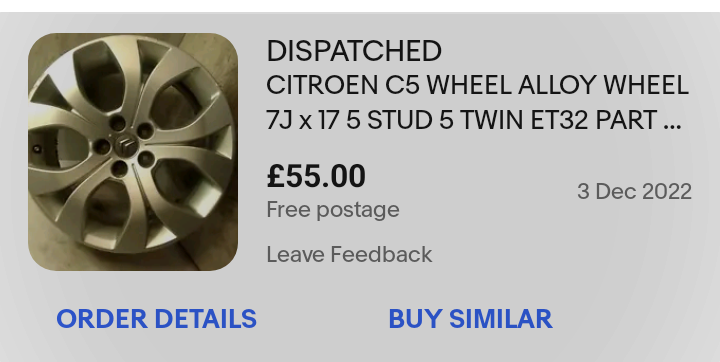

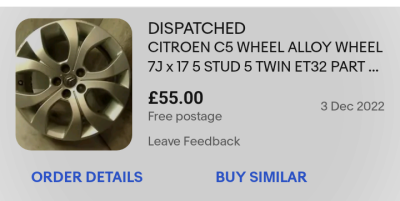

I didn't like the steel spare, which I think despite being a pretty much full size thing does still carry the 50 mph restriction. Tyre in steel spare is also rather old - original I think, so 12 years! So I've bought:
Matching alloy
Matching alloy
Which would replace the spare (or more accurately would demote one wheel to the boot when this has a new tyre fitted)
