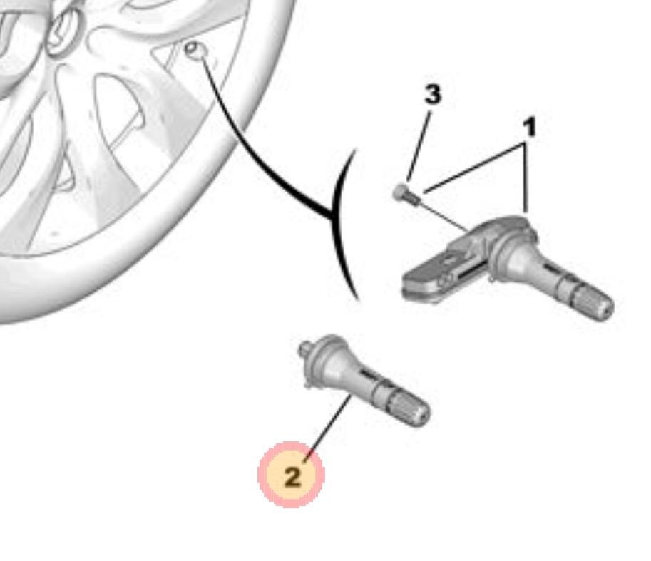

There’s an air leak in one of the the TPMS wheel sensors on my 2013 C5 Tourer X7. It takes a couple of weeks for sufficient air to leak to illuminate the low tyre pressure warning system. When washing the wheels I can see a few air bubbles around the valve stem, signifying the leak.
Do I have to buy a Citroen replacement TPMS sensor complete, or is there a quality after market equivalent that would be suitable. I’ve seen just the valve stem, washer seal and valve core available for £5 or less, including one kit on eBay,which quotes a Citroen part number. Have you tried these, and are they suitable?

You don’t need a new sensor, just the valve kit. These are a few quid frim Citroen and on tyres with factory fitted TPMS, you should replace the valve kit when this starts to happen. I have a front one doing the same. I just keep topping it up until I get the fronts done and then will get the valve kit x2 and replace them both.
The part should be
16 120 931 80
They are £5.14 per valve. Item 2 in the diagram.

They just need the screw undoing from inside the tyre on the sensor that secures it, so shouldn’t be a problem.

Perhaps bear in mind that the screw is a tiny, tiny, tiny Torx thing.They just need the screw undoing from inside the tyre on the sensor that secures it, so shouldn’t be a problem.
I've never met a tyre fitter that has anything to fit so take a set of precision Torx drivers along with you when the time comes.
