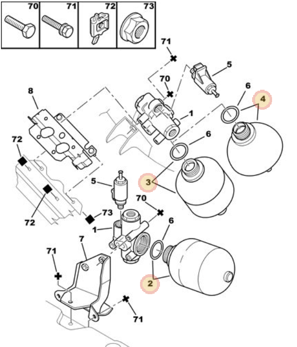

Re: Sphere identification help
You won’t have direct access, but here you go:
Item (2) Front Rigidity Regulator Sphere. 450 CM3 75 BARS:
Citroen Original, Part: 1638043580, £118.00
Citroen Cheaper Alternative, part: 1638379780, £83.35
Item (3) Rear Rigidity Regulator Sphere. 400 CM3 50 BARS:
Citroen Original, Part: 1638043680, £99.40
Citroen Cheaper Alternative, part: 1638379880, £45.23
Item (4) Sphere & Gasket. 385 CM3 50 BARS:
Citroen Original, Part: 1638045880, £173.90
Citroen Cheaper Alternative, part: 1638377080, £83.54
All VAT Inclusive, direct from Citroen.

Unread post by aerodynamica »
Just to clarify: the spheres in the diagram are front and rear hydractive regulator spheres but the OP said front accumulator. I am wondering if it's the main accumulator he means? Is this for a hydractive Xantia?
