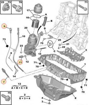

I have a similar issue to others with the 2.0 HDi engine with the dipstick being broken, it was not on inspection when viewing the car prior to purchase so am in a position where i cannot rule out an engine oil leak.
Coupled with this i have an issue with the dashboard oil level check which is coming up as "Oil Level Invalid " so did a Lexia session and it is reporting a fault with the oil level but cannot remember the code.
Now i think the leak is Brake fluid related as the pedal travel is way too much and does not seem to have resistance, a bit like the brake bleeding process without the resistance if that makes sense yet the fluid level seems to be within the marks.
So can anyone tell me the part number for the oil dipstick, hoping it is the same as used on my C5 as i can interchange them to manually check levels as a first step.
Next question is i have looked at what i believe is the oil level sensor on the sump, is that a simple unscrew and replace, i get the feeling the sensor is faulty but still reporting ?

Ok, so here you are:
(07) is the Engine Oil Gauge 1131K6 £20.02
(09) is the Dipstick (614 long) 1174G9 (Replacement Part) £20.02
(11) is the Engine Oil Pressure Switch 1131C5 for reference £19.75

Thanks Marc
Would i be correct in saying that part #7 is the one that is responsible for the on dash message about oil level that has a plug socket on the end of it, sorry for non mechanical terms
The dipstick #9 ( not referring to me this time ) is the updated version i guess so both parts for £40 + vat from Citroen is something i can live with, all i need to do now is work out what and where the leak is

Yes you would be correct about no 7 Colin. Assuming your plug is fitting properly on the existing one?
- x 6957
Re: C4 2010 2.0 Hdi issues help needed.
Yes that's the one.
