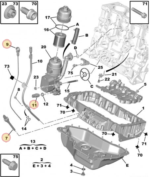

Ok, so here you are:
(07) is the Engine Oil Gauge 1131K6 £20.02
(09) is the Dipstick (614 long) 1174G9 (Replacement Part) £20.02
(11) is the Engine Oil Pressure Switch 1131C5 for reference £19.75

Would i be correct in saying that part #7 is the one that is responsible for the on dash message about oil level that has a plug socket on the end of it, sorry for non mechanical terms :)
The dipstick #9 ( not referring to me this time ) is the updated version i guess so both parts for £40 + vat from Citroen is something i can live with, all i need to do now is work out what and where the leak is :)
Colin
Posts: 21127
x 8114
Re: C4 2010 2.0 Hdi issues help needed.
Yes you would be correct about no 7 Colin. Assuming your plug is fitting properly on the existing one? :)

Yes that's the one.
