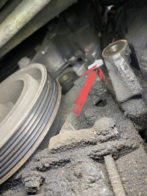

I have marked in the pic where the bit is broken it has caused the belt to come off so i got no power steering.

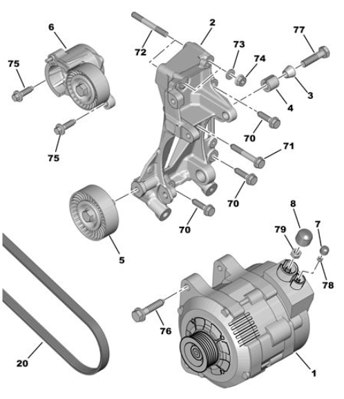

You've added a few more pictures since the original - are we still talking about the same thing:
These are the alternator fixings which resemble the part in the previous pictures:
Item (2) is the Alternator Bracket and has been replaced with 2 new parts:
5706K5 (bracket) + 5751E4 (Retractor Roller) - you need both
£84.66 for the bracket and £56.30 for the roller.

Presume it is the tensioner to the right in that picture? It's not at all clear, it might be bolted to the engine bracket Marc listed, or it might be bolted to the block... You are going to need to get the bracket off to have a look at it to determine whether it's repairable or not.
Although if you look here: https://www.eurocarcare.net/mountings/e ... acket.html there are 2 threded bosses at the bottom which match the positions of the bolts on the tensioner, so I think it is on this mounting bracket.
