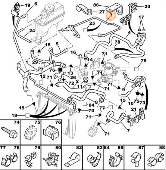

Re: Xantia Parts Request
If its number 3 you need im afraid its no longer available from Citroen Part no 1351X7
what is the other pipe you need?
Hi wheeler.
I managed to split a tiny bit of it where it kicks back towards the cambelt. Should be alright... Fingers crossed.
Looking at that diagram, I am guessing it's no. 4 but I would need to look at it next time I am with the car.
No. 1 would be worth doing I think.
4 is the heater matrix pipes, no longer available either im afraid.

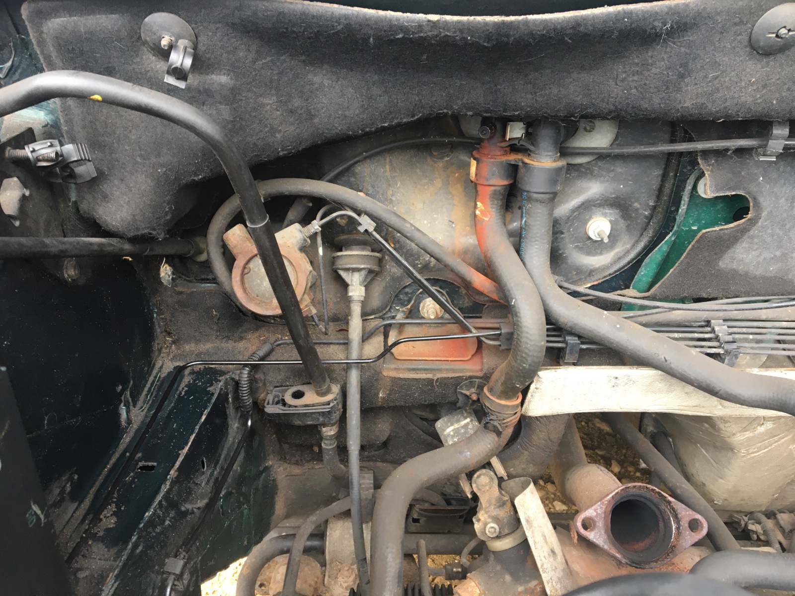

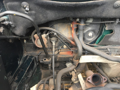

Hi Quintet,quintet wrote: 28 Aug 2021, 12:09 I think I've got pipe No4 but i bought it for my 1.9td (without ac) & I'm not sure what other vehicles/engines it will fit. I think i posted a photo of it on the "for sale" thread for my own car.
I haven't fully assessed my heater matrix pipework as yet but how much are you looking for for pipe No.4 please?
I'll upload a photo of mine. My mate reckons it has a problem but I think the stains are from when I flushed the engine with spirit vinegar as I left the top bleed cap off for probably an hour and just kept adding hot water to the expansion tank.
I would advise leaving the heater matrix connector alone, as they are usually well stuck in place, and there is a chance of breaking the connector or matrix when you try to separate them.
I would dearly love to but I am 100% I could smell vinegar in the car after I flushed it so needs must! Heater matrix needs replacing methinks. Trust me! I really don't want to do the job because it is a 10 hour job unless anyone knows any useful shortcuts? I did it on Sylv's ZX and the damned thing went again 18 months later... It's sat on the drive for 8 years!xantia_v6 wrote: 08 Sep 2021, 11:10 I would advise leaving the heater matrix connector alone, as they are usually well stuck in place, and there is a chance of breaking the connector or matrix when you try to separate them.
Agreed, if it was me id leave it alone too unless i was prepared to change the matrix, they can and do snap. If i wanted to flush it I would remove the hoses at the engine end & do it that way. Your choice of course.xantia_v6 wrote: 08 Sep 2021, 11:10 I would advise leaving the heater matrix connector alone, as they are usually well stuck in place, and there is a chance of breaking the connector or matrix when you try to separate them.
See above Wheeler.wheeler wrote: 08 Sep 2021, 12:40Agreed, if it was me id leave it alone too unless i was prepared to change the matrix, they can and do snap. If i wanted to flush it I would remove the hoses at the engine end & do it that way. Your choice of course.xantia_v6 wrote: 08 Sep 2021, 11:10 I would advise leaving the heater matrix connector alone, as they are usually well stuck in place, and there is a chance of breaking the connector or matrix when you try to separate them.
I think the matrix is holed.
I know I can't face doing it with the cylinder head back in place. Just having this amount of access makes me think it will save at least two hours. It was horrendous on the ZX to change. Getting access to the cover plate was nigh on impossible. BoL says you should remove the rocker cover for better access!
