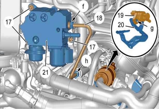

There's nothing requiring that the high pressure fuel pump needs coding - it is just a replacement, along with the high pressure fuel hose (18) that must also be replaced at the same time:

I don't think that the Citroen part number is stamped on the pump, so knowing the Citroen number may not help to identify a used pump.
Pump replacement is quite easy after removing the air intake pipes.
