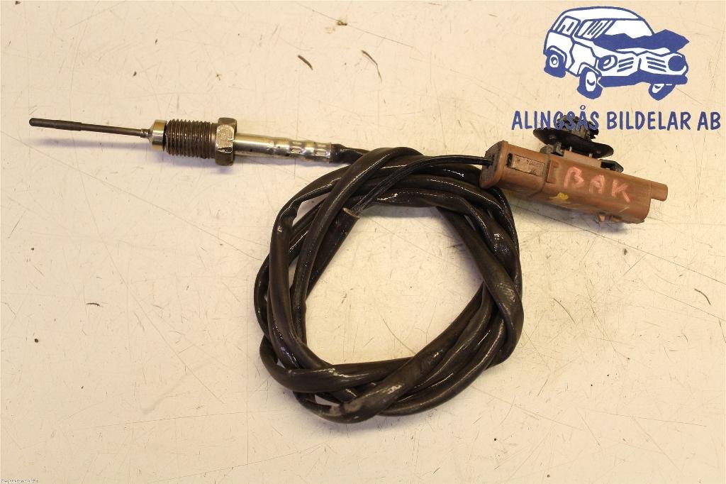

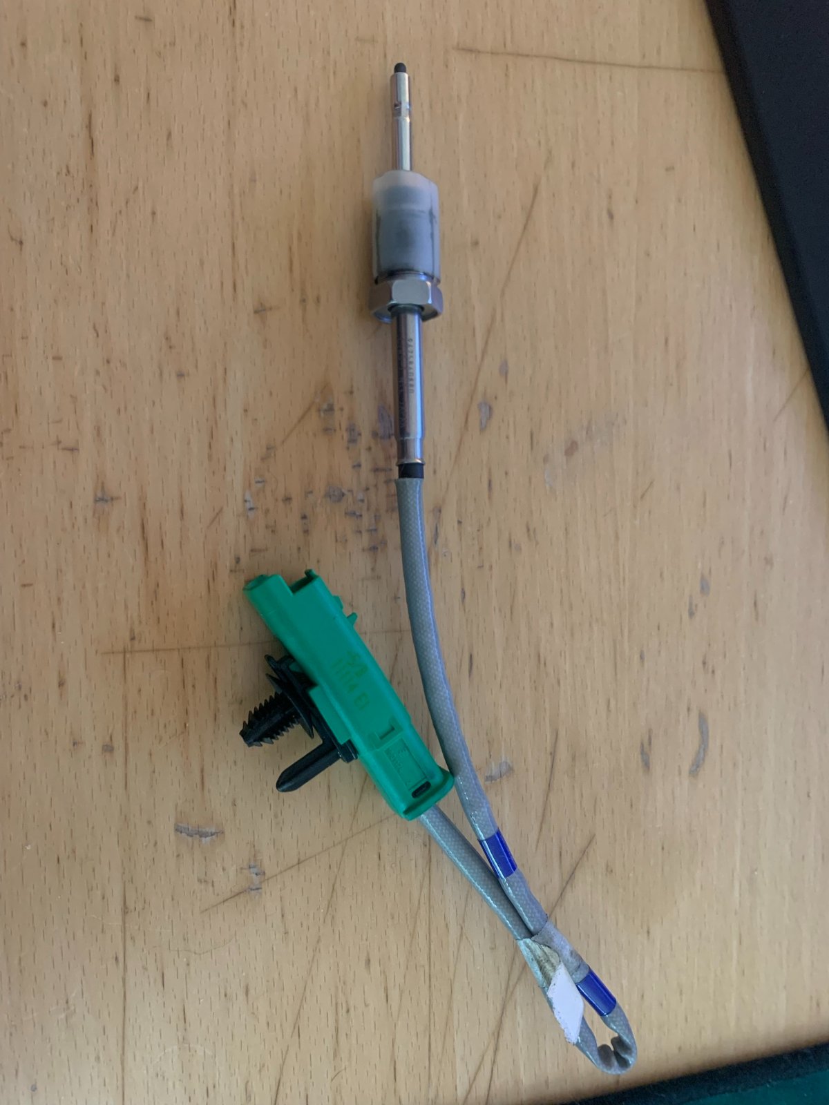

The OE 1618 sensor on the Particulate filter is dead.
i ordered a new OEM matching part from autodoc, but they are not completely identical.
The old sensor on the car is slightly different to the new part i got, BUT OEM numbers match.
the wire is physically WAY to short, but i can cut it and solder it so it could fit.
A picture of the old and new sensor is attached.
They both "protrude" the same length into the DPF, Only the tip is different, same length though.
will the new sensor work or not?
Does anyone have experience with this?
The Numbers match, and it fits perfectly into the DPF.

The OEM part number is often used for references by aftermarket suppliers - but in no way indicates the same quality as the OEM - you will find variants in price and quality. You can't beat an OEM part if you want 100% quality and a guaranteed fit for replacement.

Soo the sensor is a maybe will it work or?
looking away from original parts. i'm not pinning anyone down if you say it works and it doesn't. i just want other peoples point of view before butchering the wires. ( https://www.autodoc.dk/fispa/13962538 ) im also thinking about crocodile clips on the pins and the wires to test. the old sensor reports random temps when driving and with engine idling 20c - 800c.
I know OEM is 95% of the time the best option, there's just a 120£ price difference, i can still return the new sensor , but don't want to pay over 200£ incl. tax for it. (Got it for 83€) i may have to though.
Have you seen it used before? in my eye's it's just a NTC resistor at the tip.
I'm just afraid that OEM numbers from autodoc is incorrect and not matching.

So you don't have to look it up, i only want to hear if anyone know if it might work, as said i can still return it, IF i don't cut the wires.
Numbers match, only wire length and "Design" of the part is different.
