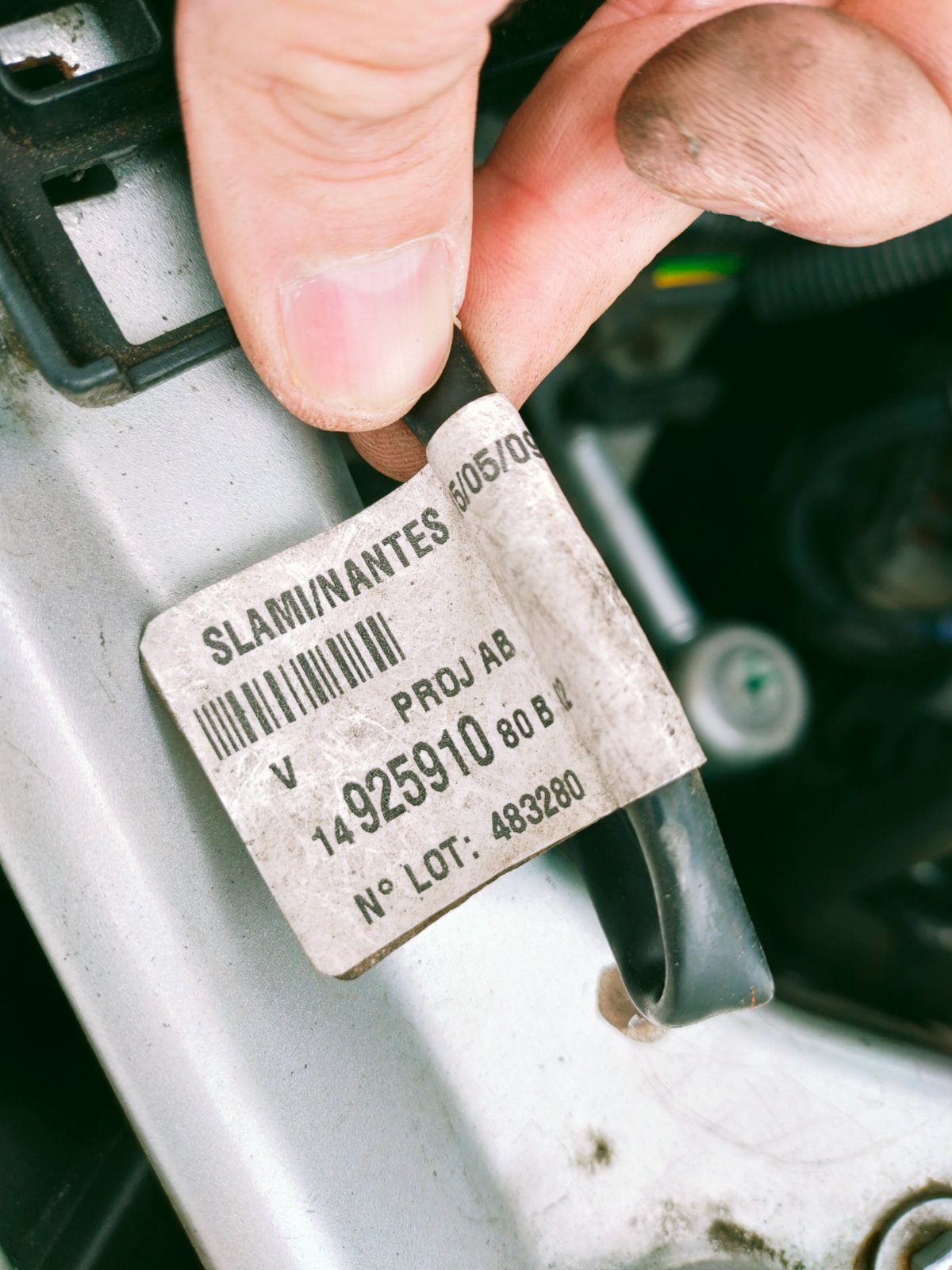

Whilst doing some maintenance on the 807 I came across two zipped tied wires at the front of the car.
I've attached pictures of coding for them in the hope that you lovely FCF boffins can tell me what they are.
Secretly hoping it's the plugs for the front parking sensors 🤔

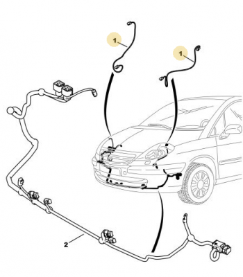

Unfortunately not, those are the wiring connectors for the front fog lights.
See on the Diagram item (1) - this is the harness in your picture. Harness (2) below that is for the front obstacle detection.
