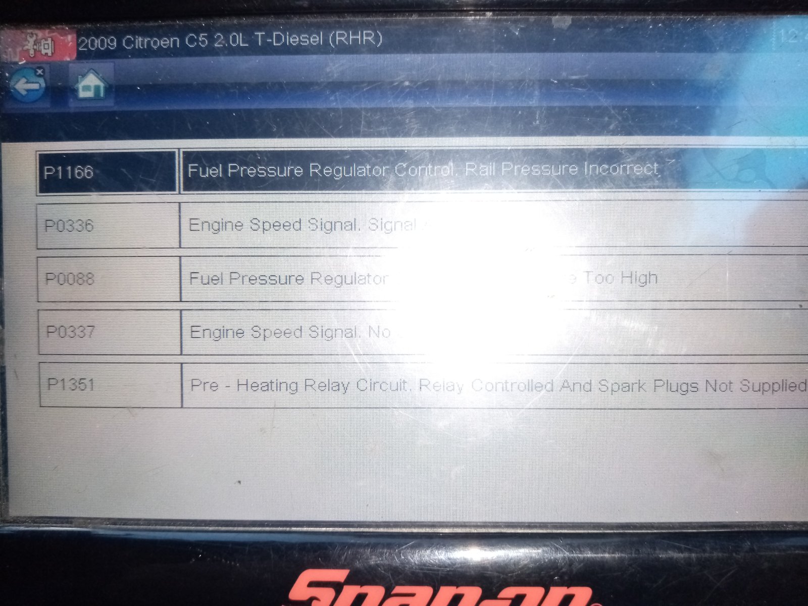

Thank you for the replies I have checked with snap on tool as not had time to get lexia out yet but here are the codes (sorry about quality of photograph
Regards
Steve

Ignore the last one, as it seems to be a 'standard' fault with HDi engines on Citroens (even if there is nothing wrong with the car).

I'll respond back tomorrow on the codes Steve when I'm on my main rig, but these will be related to the issues no doubt.

Ok, so here are the fault descriptors. Ignore P1351.
I would focus on faults P0336 and P0337 as these both relate to the engine speed sensor (crank sensor). SO i would replace that first and then clear the faults, go for a drive and then see if any of those return. I suggest you forget ECP for a replacement sensor as they are known to ship dud parts.
As you probably know by now - if you need parts info Steve, then see the following: A £10 Forum donation will get you parts info and parts diagrams for up to 2 years, details in the table links.
| Fault Code: P0088 Description of Fault: High pressure fuel regulation: The measured rail pressure is too high in relation to the set point. The ECU detects a difference of 180 bars to 250 bars for 3 to 6 seconds between the rail pressure set point and the measured rail pressure. Conditions for Fault to clear: Driving for 5 minutes with several full load accelerations for 10 seconds Downgrade Modes whilst Fault is active: Deactivation of processing of the accelerometry; Deactivation of the accelerometry strategies; Deactivation of the detection of loop difference on the fuel flow rate regulator; Deactivation of the injector flow rate correction strategy. Symptoms: Jerking/stalling, Unwanted acceleration, Noise, Smoke from the exhaust, Lack of power, Starting problem. Suspect Areas: Engine ECU (Software not up to date), Poor fuel or polluted fuel (petrol, deposit, etc.), Problem on the fuel low or high-speed circuit (hose, tank, diesel fuel filter, etc.), Fuel injectors, Engine fuse box, Electrical harness, Connectors, high pressure fuel pump, Fuel high pressure sensor |
| Fault Code: P0336 Description of Fault: Engine speed signal: Absence of signal under starter. Absence of signal from the engine speed sensor on starting Conditions for Fault to clear: Under starter Downgrade Modes whilst Fault is active: None Symptoms: Starting problem. Suspect Areas: Engine speed sensor, Engine speed sensor target, Electrical harness, Connections |
| Fault Code: P0337 Engine speed signal: Signal not coherent Description of Fault:The number of teeth seen on the target of the engine speed sensor is too low on 1 engine rev. The fault is forwarded after 2 engine revolutions. Conditions for Fault to clear: Under starter Downgrade Modes whilst Fault is active: None Symptoms: Starting problem, Jerking/stalling. Suspect Areas: Engine speed sensor target, Engine speed sensor, Electrical harness, Connector |

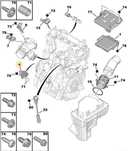

Thanks for that Steve - so here is the part in question:
Part 1920GJ, item (4), £61.66 inc. VAT for the OEM one from Citroen. No guarantees of course this will resolve the issue, but 2 of the fault codes do point to this as a possible suspect.
