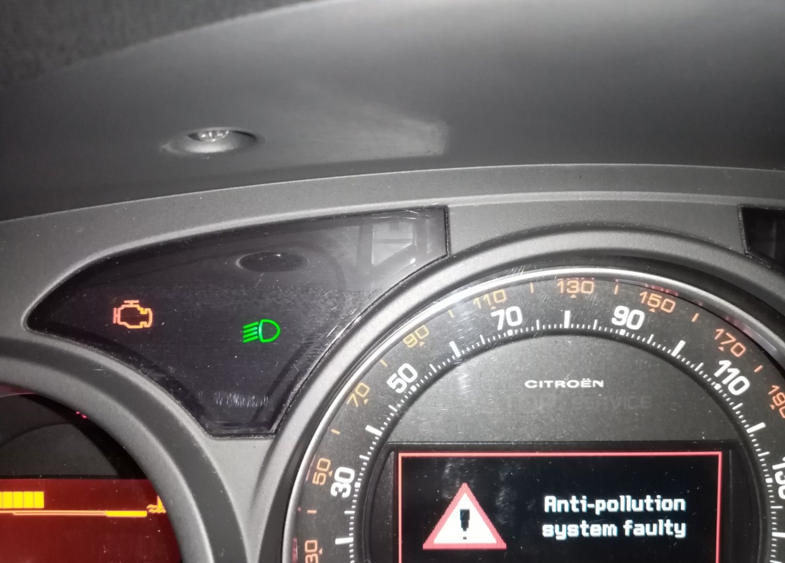

Good morning Ladies and Gentlemen
First of all Merry Christmas to everyone I hope its a safe Chrismas for you all and a better New year.
So here goes
This is the second time this has happened to me over a two week period. Car running smooth and no loss of power and then the car engine just cuts out without warning.
The car will restart after a few seconds but then comes up with the eml and the message above, no loss of power and engine pulls like a train.
One thing I did notice though on a previous thread I have had an issue since owning the car when setting off from junctions etc (possible clutch switch /anti stall etc) with the car trying to stall.
With the eml light on this now appears to be a lot better as though it disables certain functions including the clutch switch.
While taking the photograph above I noticed after 4 restarts the eml went out and I had no anti pollution message on screen.
This appears to happen when the fuel level is low but no fuel light on.
I have checked the fluid (anti pollution) and I have around 3/4 litre left.
I would be grateful if someone could tell me if its pat fluid or Eolys used in my car.
Thank you
Regards
Steve

You'll need to get scanned to see what fault is recorded. Anti pollution is just generic engine fault. Total cut outs when just cruising are unusual, however....
- x 6945
Re: Anti pollution fault
There are many fault codes that have backup modes Steve, which will range from power limitations, to cutting of EGR functions, cruise control, regeneration and the like. Very important to get the codes - or you can end up making unnecessary measures / repairs / replacements.
