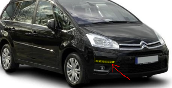

The DRLs I have highlighted in Yellow and marked in Red:

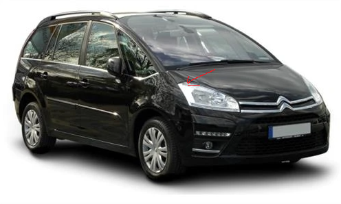

So I have done a full scan of all the lights and the only ones that do nothing are the ones highlighted in the image below
but on further inspection under the bonnet, these lights are attached to plastic clips and have no cables running into them at all

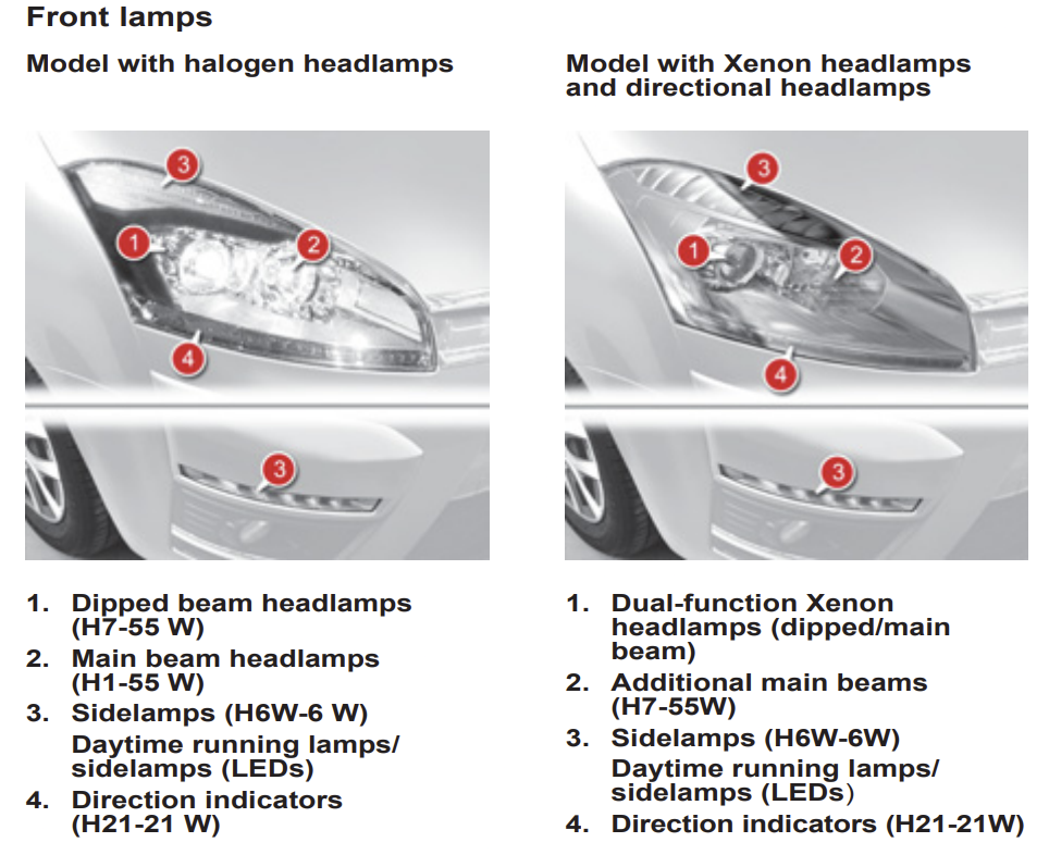

It might help if you pop your VIN up here (it will be masked on submission) and then I can see the exact lights you are referring to once we have the exact model. However if this the Mark I C4 Picasso 2013, then the side lights shown use H6W-6 W bulbs:

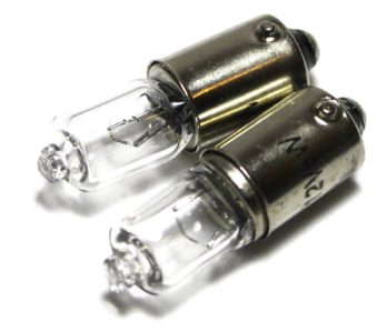

These things:
The power for these may be supplied by the lamp housing itself like on the rears, so you won't necessarily see any wiring. The plastic holder requires a quarter turn anti-clockwise to remove.

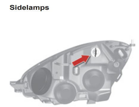

These things:
It's all in the manual.

What it does say in the manual that when LED lamps are fitted (which they are are, above the fog lights) the filament bulbs for the side lamps in the front lamp units are not used
