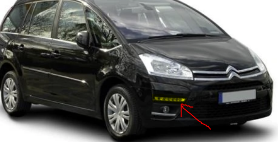

For reference it looks like this Image

Well it should be down to the MOT people to tell you which ones and point them out to you as their terminology is not always correct.
Headlamps - obvious enough if these are working for Low and high beam, or not and the same for the DRLs, Fog Lamps and sidelights.
The only exception is if you have Xenon Directional Headlamps - but if these are not working bulb-wise it will still be obvious. They only check that the bulbs are working and that the beam pattern is correct, not the directional function - and you can temporarily turn this feature off for the MOT anyway if you have these fitted, should you wish.
So if you think ALL the lamps and bulbs are working, then you need to go back and get them to explain - you have paid for a test and are entitled to know what they have found a problem with.
If your LED DRLS are not working then this will likely be a fail as they were required on cars from about 2011 on I think.
The DRLs I have highlighted in Yellow and marked in Red:

They are what used to be called parking lights or sidelights.
It looks as though those are part of the headlight assembly, assuming that the lights below the DRLs are foglights.
Check your handbook for the fuses as it is unlikely that both will fail at once although that can't be ruled out. Do the tail lights work - these should be on at the same time.
They could be easy to change or very awkward. C5 ones weren't too bad but the rest were a bit of a nightmare.
