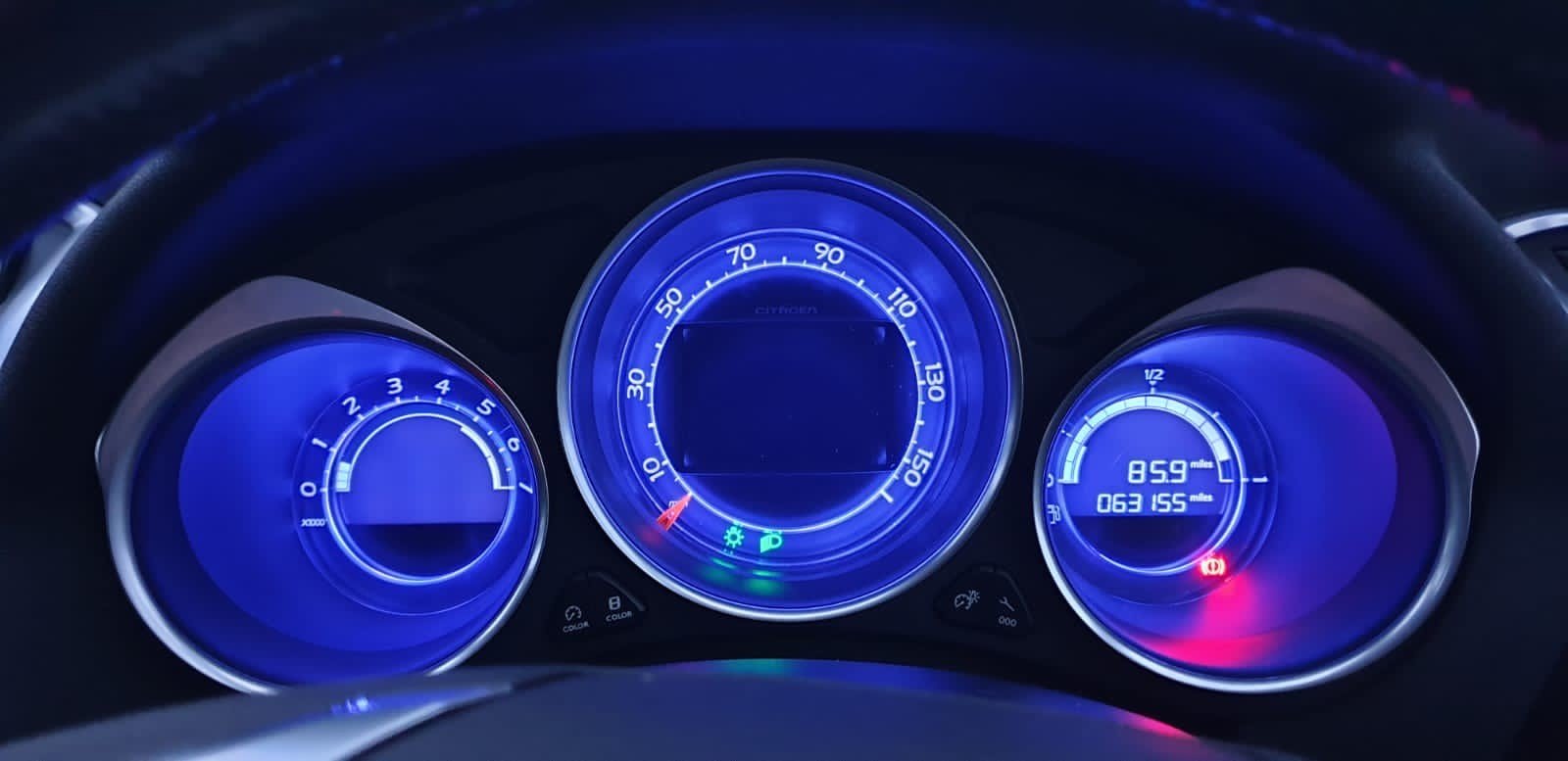

The centre speed LCD display is out and not working, I wondered if anyone can help diagnose the fault, or if you know where this can be reparied?
I have attempted to attach a photo.

It's very likely the Matrix Display has failed and needs to be replaced. Pop your VIN up and I can check whether you have the removable one or not.

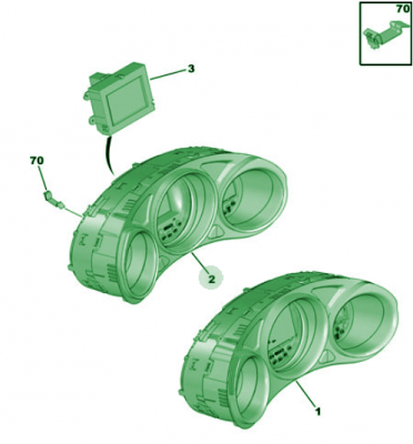

There are 2 types of instrument cluster. You have the type marked as item (2) below that allows for the matrix (3) to be replaced.
6155JA was the original Matrix Part Number which needs configuring and has now been updated with Part: 1613424380 which is the newer model. It costs £450.73 from Citroen as of today inc. VAT.
1606616780 is the part number for the Clips, item (70) (£6.07 inc. VAT).

Much appreciated, do you have the part number of the enitre instrument cluster (item 2) too in case I can find a used part, with lower mileage.

The Instrument Panel Item (2) is replacement part number: 9812834580. Remember only the higher of the 2 mileages of either the BSI or the instrument panel will be set once connected - so be sure if replacing the instrument panel that it is near or below the current mileage of you vehicle as I'm sure you know :-D
