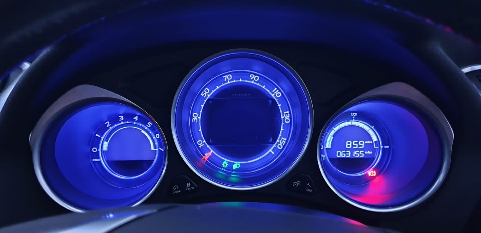

The centre speed LCD display is out and not working, I wondered if anyone can help diagnose the fault, or if you know where this can be reparied?
I have attempted to attach a photo.
Thank you!

It's very likely the Matrix Display has failed and needs to be replaced. Pop your VIN up and I can check whether you have the removable one or not.

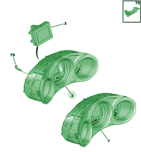

There are 2 types of instrument cluster. You have the type marked as item (2) below that allows for the matrix (3) to be replaced.
6155JA was the original Matrix Part Number which needs configuring and has now been updated with Part: 1613424380 which is the newer model. It costs £450.73 from Citroen as of today inc. VAT.
1606616780 is the part number for the Clips, item (70) (£6.07 inc. VAT).
As it turns out the configurable part is no longer available.
I will put together a quick illustrated guide for removing the display shortly with a link.
