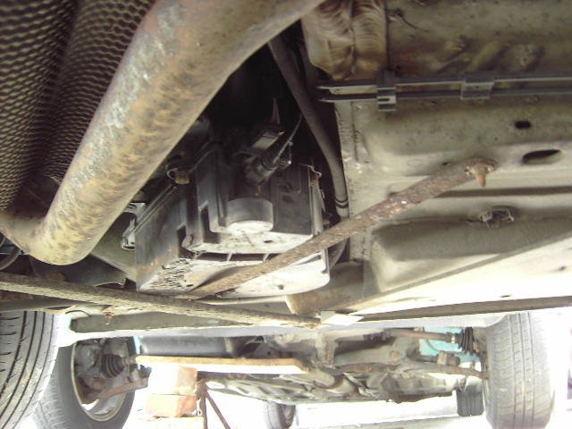

I drove the car home but after about half an hour on the motorway it lost power, still doing 70mph but no power to overtake, anti pollution warning came up a few minutes later. I wasn't far from the services so i pulled in and phoned the RAC thinking they may be able to fix it or tell me what the problem was. RAC tried to do a forced regeneration but got a message saying this was not possible as DPF fluid was low. They advised me not to drive it as it may cause damage so they recovered me home.
I'm sure I can solve this with some help from FCF but my first problem is finding a workshop manual. Haynes manual doesn't cover 307cc, sport or 16v models, anyone know where I can get one? I thought locating the DPF tank or pouch would be a good start so I rang the Peugeot dealer to find out if it has a tank or pouch and how much the fluid is. They told me it has a pouch Part No. 9690680808 so I jacked the car up yesterday to locate it and the DPF filter, please see photos. I assume the silencer shaped thing is the DPF filter and the steel pipe connecting to the exhaust in front of it is to do with the pressure sensing system and assume there's another one the other side of the filter. I thought I'd remove, clean and check it and if necessary replace it. Looks like it's held together with 4 nuts and looks easy to remove, rusty nuts & bolts permitting. I'm also assuming the small black box behind the fuel tank is the DPF tank, but dealer said it's a pouch, is the pouch inside this box or it the box the tank? It seems to have a quick fit connector with a small pipe at one end and and a connector with 3 wires above it which I assume is a sensor. I removed the strap but something on top seems to be holding it, tried to see if I can get access from inside, under the back seat, but not been able to work out how the seat is fixed in. Looks like there are fixings round the edge of the box (tank) which makes me think this is a box with removable cover that holds the pouch. To get this out looks like I may need to remove the strengthening brace which doesn't look like it's been removed for years! I don't want to force anything as I'm afraid if I break something it'll be expensive or not available.

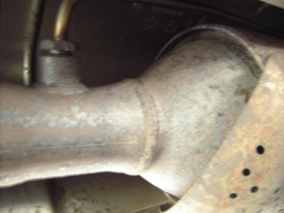

I'm assuming the object in the photos is the DPF filter but where is the cat? I'm assuming it has one.

You do have a pouch system in this vehicle, but the part number you have is not a a valid part number.
Be aware that you will need access to a 'Lexio Kit' with Peugeot Planet 2000 or Diagbox software in order to reset the additive counter after you replace the pouch. If you don't, the Engine ECU will not be aware that you have replaced the pouch, and as a consequence you will still be in reduced power mode and have the fault codes.
Before taking the DPF off, again, you really should get it diagnosed with the same equipment to see whether the filter itself is ok. This will depend on mileage of course. Cleaning it needs extreme care as if you damage the special cement inside it will break up and become useless. You can never fully clean these anyway as they are highly porous. The engine oil deposits, carbon and Cerine from the additive cannot be fully removed by cleaning.

Original Silicon Carbide DPFs are used by the majority of manufacturers. There are smaller DPF cores and larger DPF cores. Where the DPF uses larger cores, they are made in segments and due to the high coefficient of linear expansion, a special cement is used to hold them together that allows them to expand. High pressure washers or bashing these about can damage the cement and ruin the DPF.

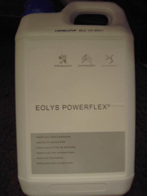

Sorry, typed the number in wrong, number dealer wrote down for me was 9678080680, don't know where the other number came from. I found this number in ebay listings but the vehicle compatibility checker says it won't fit my car.
I've heard that there are at least 2 types of fluid and one aftermarket manufacturer claims their fluid is suitable for all. Don't want to pay dealer prices if I can avoid it but I don't want to use anything that may cause damage, is there a cheaper alternative? I've also heard the pouches are prone to leaking, is this an issue on my car?

That's more like it :-D 9678080680 is correct and that is a pouch and the additive is called Eolys 176. It is currently selling at Peugeot for £184.44 inc. VAT.
Normally with the rigid reservoirs, certain generations of additives cannot be mixed together or it will cause damage to the system. In your case you have a soft pouch, so the whole thing is replaced, which negates this problem.
So Eolys 176 is no longer sold, and Powerflex is the fluid that is specified for the part number and comes in a 3 litre soft pouch.

I know topping up isn't recommended but I got a genuine Peugeot top up kit for £60, new, unused and seals not broken. Whether I use it or not depends on what I find when I take it apart. If I don't use it I'm sure I can move it on and get my money back, seen these listed for over £150.
Will Powerflex safely mix with Eolys 176? Kit I got is marked Eolys Powerflux so I assume it contains the Powerflux replacement fluid. I don't know what the system contains or when it was last changed as these last a long time. I assume the system contains Eolys 176 so if I put Powerflux in the pouch or replace the pouch with one containing Powerflux will it do any harm?
