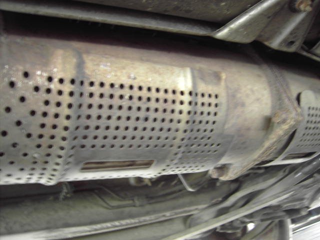

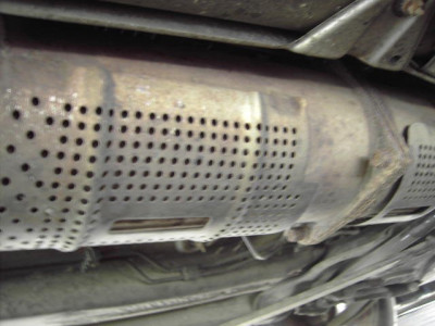

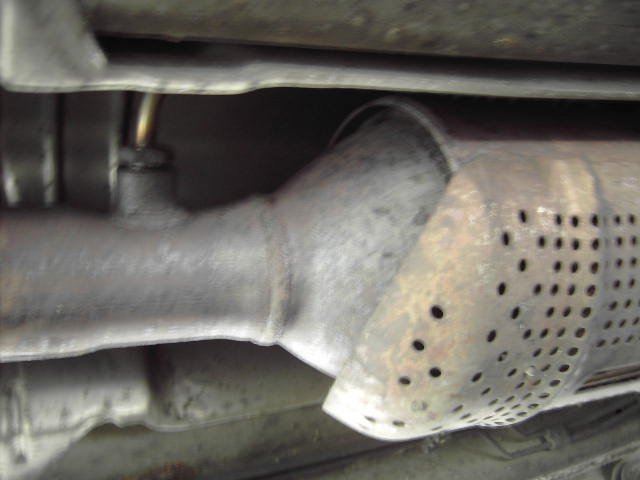

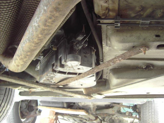

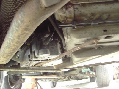

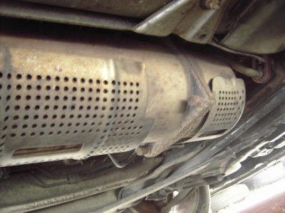

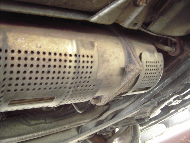

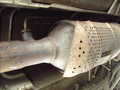

I'm sure I can solve this with some help from FCF but my first problem is finding a workshop manual. Haynes manual doesn't cover 307cc, sport or 16v models, anyone know where I can get one? I thought locating the DPF tank or pouch would be a good start so I rang the Peugeot dealer to find out if it has a tank or pouch and how much the fluid is. They told me it has a pouch Part No. 9690680808 so I jacked the car up yesterday to locate it and the DPF filter, please see photos. I assume the silencer shaped thing is the DPF filter and the steel pipe connecting to the exhaust in front of it is to do with the pressure sensing system and assume there's another one the other side of the filter. I thought I'd remove, clean and check it and if necessary replace it. Looks like it's held together with 4 nuts and looks easy to remove, rusty nuts & bolts permitting. I'm also assuming the small black box behind the fuel tank is the DPF tank, but dealer said it's a pouch, is the pouch inside this box or it the box the tank? It seems to have a quick fit connector with a small pipe at one end and and a connector with 3 wires above it which I assume is a sensor. I removed the strap but something on top seems to be holding it, tried to see if I can get access from inside, under the back seat, but not been able to work out how the seat is fixed in. Looks like there are fixings round the edge of the box (tank) which makes me think this is a box with removable cover that holds the pouch. To get this out looks like I may need to remove the strengthening brace which doesn't look like it's been removed for years! I don't want to force anything as I'm afraid if I break something it'll be expensive or not available.
I'm assuming the object in the photos is the DPF filter but where is the cat? I'm assuming it has one.

Re: Re: 307cc DPF fluid top up, pouch or tank?
You do have a pouch system in this vehicle, but the part number you have is not a a valid part number.
Be aware that you will need access to a 'Lexio Kit' with Peugeot Planet 2000 or Diagbox software in order to reset the additive counter after you replace the pouch. If you don't, the Engine ECU will not be aware that you have replaced the pouch, and as a consequence you will still be in reduced power mode and have the fault codes.
Before taking the DPF off, again, you really should get it diagnosed with the same equipment to see whether the filter itself is ok. This will depend on mileage of course. Cleaning it needs extreme care as if you damage the special cement inside it will break up and become useless. You can never fully clean these anyway as they are highly porous. The engine oil deposits, carbon and Cerine from the additive cannot be fully removed by cleaning.

x 3306
Special cement or special ceramic, Marc?
x 6957
Cement
Original Silicon Carbide DPFs are used by the majority of manufacturers. There are smaller DPF cores and larger DPF cores. Where the DPF uses larger cores, they are made in segments and due to the high coefficient of linear expansion, a special cement is used to hold them together that allows them to expand. High pressure washers or bashing these about can damage the cement and ruin the DPF.

I've looked on ebay and from what I can see the DPF is secured to the cat with 4 nuts & bolts, is that correct? After reading your comments I think I'll leave the DPF well alone until it causes a problem, then I'll try to clean it and if that fails or I break it I'll replace it. The utube video I watched of how to clean a DPF showed it being treated very roughly and cleaned with a jet wash! After reading your comments I'm glad I didn't follow that procedure!

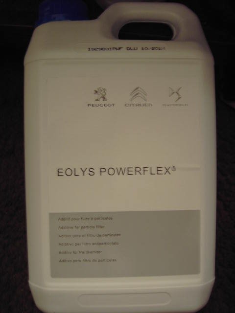

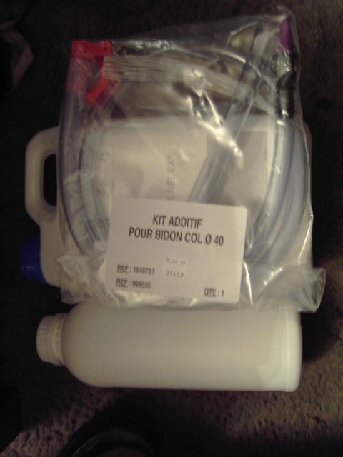

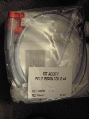

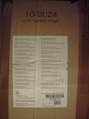

I know topping up isn't recommended but I got a genuine Peugeot top up kit for £60, new, unused and seals not broken. Whether I use it or not depends on what I find when I take it apart. If I don't use it I'm sure I can move it on and get my money back, seen these listed for over £150.
Will Powerflex safely mix with Eolys 176? Kit I got is marked Eolys Powerflux so I assume it contains the Powerflux replacement fluid. I don't know what the system contains or when it was last changed as these last a long time. I assume the system contains Eolys 176 so if I put Powerflux in the pouch or replace the pouch with one containing Powerflux will it do any harm?
I looked on ebay and all the pouches I found were 2.2 litre and although they have the correct part number the compatibility checker say they won't fit my vehicle. Is this because I should have a 3 litre pouch or is the checker wrong? I know these are often wrong and most sellers warn to check if unsure because of this. Photos of top up kit attached which show the part numbers if required.
