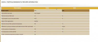

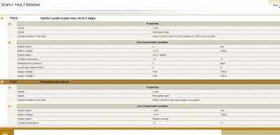

Re: DPF health check
Managed to find the DPF data (41% full?). The faults are at the last attachment.

You can realistically ignore the P1351 error - just about every HDI has this. It's just the common glow plug fault.
The DPF data 41% PEFload is just telling you the current status of the soot loading. That will increase upwards until it's time to regenerate and will drop back off again.
As for P0215:
So this is likely to point to the fuel supply relay - which is contained in the engine fuse box. The relays are not really user serviceable, so the whole fusebox is generally replaced. You might find that it behaves for a while, but may start getting progressively worse - other symptoms can include cutting out / hesitation whilst driving.
As for P0215:
| Fault Code: P0215 - Supply relay control - short circuit to earth or short circuit to positive or open circuit Description Main Relay Stuck Conditions for Fault to clear: The following conditions have to be met: - Engine idling (For several seconds) - Engine cut following a phase in which the engine management ECU becomes dormant Downgrade Modes whilst Fault is active: None Symptoms: Starting Problem Suspect Areas:Engine fuse box, Electrical harness, Connector |
