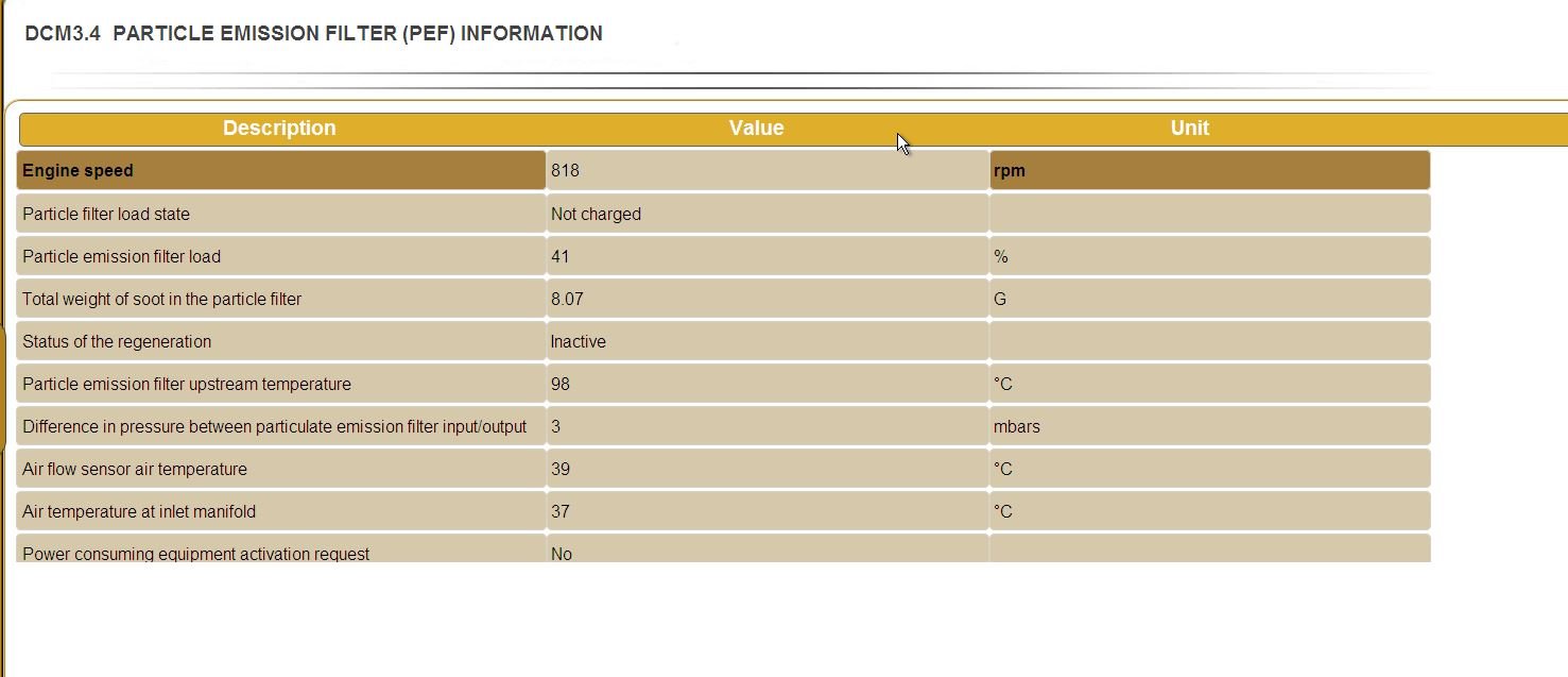

Managed to find the DPF data (41% full?). The faults are at the last attachment.

You can realistically ignore the P1351 error - just about every HDI has this. It's just the common glow plug fault.
The DPF data 41% PEFload is just telling you the current status of the soot loading. That will increase upwards until it's time to regenerate and will drop back off again.

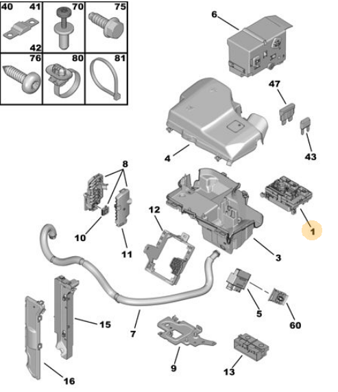

Is the fusebox easy to replace? What part number do I need to look for? VF7**************[VIN obfuscated, can be read by forum staff]

Try a BSI Reset first (BSI Reset / Battery Disconnect / Reconnect Procedure) , as this will remove all power and might sort the relay - if not and you need up to date parts data, you'll probably be aware that we are now charged by PSA for this, so ask for a small contribution (£10 min) that will cover you up to 2 years for future parts and parts diagrams - details below:

Engine Fuse box specifically for your X7 is Part number: 9807028580. Current Citroen price is £131.69 inc. VAT. Eurocarecare (not to be confused with Euro Car Parts) are a decent supplier and have a new fusebox for £100.80 inc. VAT. Beware some ebay sellers are charging more than Citroen!

Just had a look and it's BSM-9664705980 (R02). Guess they are interchangeable?
