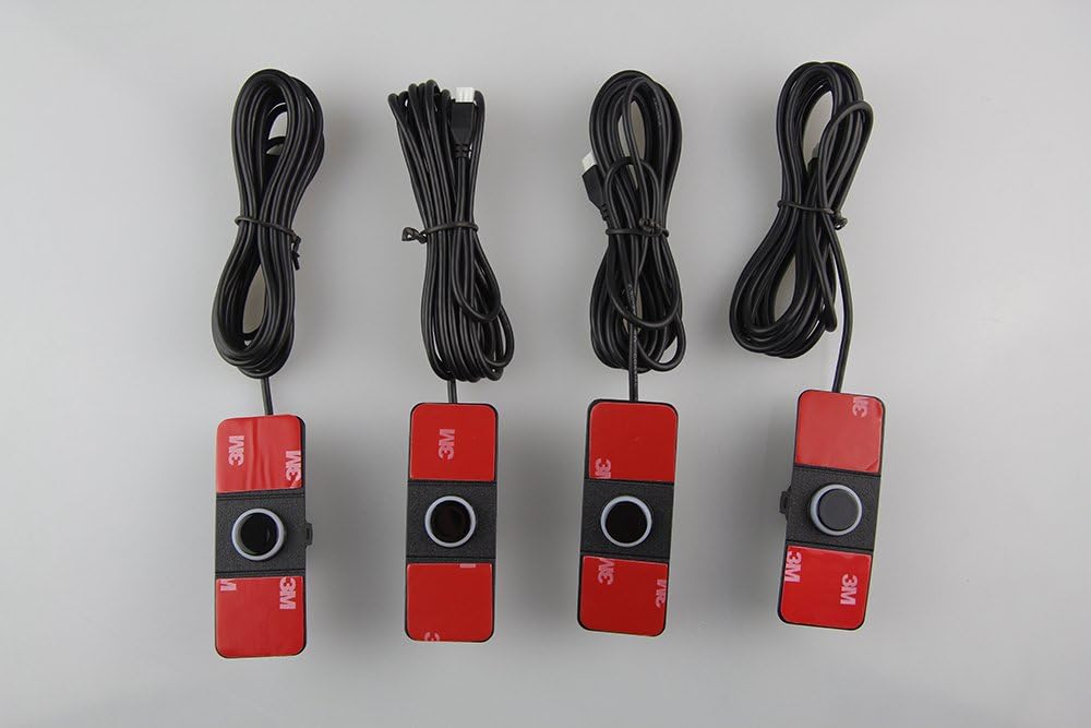

I wanted to put one already with a reading unit. I leave an example:

Ok, so you want to fit an aftermarket one.
All I would say is don't attempt to wire it into the vehicle's existing wiring systems or you may cause faults in other systems. These vehicles are multiplexed - so send coded signals on the various data networks to the various ECUs on the vehicle. Tapping into one of these networks can cause a breakdown. If you are thinking about fitting one, then make sure it is compatible with CAN vehicles or can be wired in such a way as not to interfere with the vehicle's systems.
Citroen did provide 2 after-sales reverse parking assistance systems (one a sticky strip inside the rear bumper and another that had ultra sonic sensors drilled into the rear bumper), but nothing for the front.
Obviously the rear system needed to tap into the reversing light wiring to activate, but there won't be anything like that on front, so I guess it may be permanently active on the front.

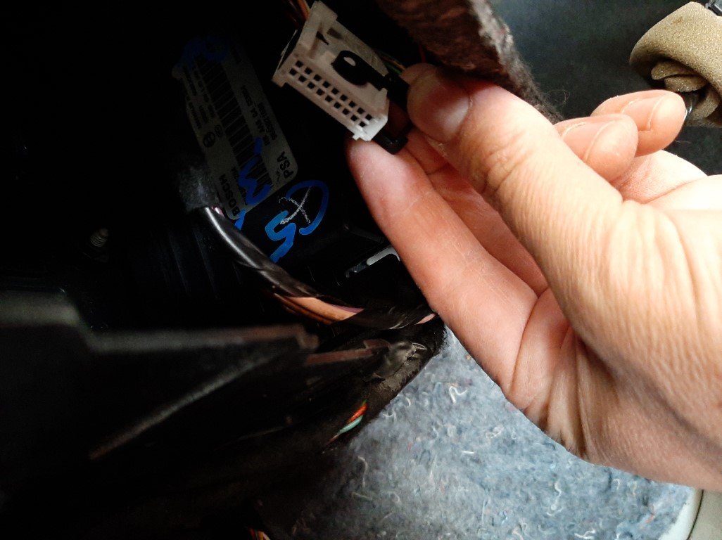

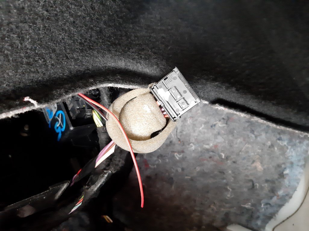

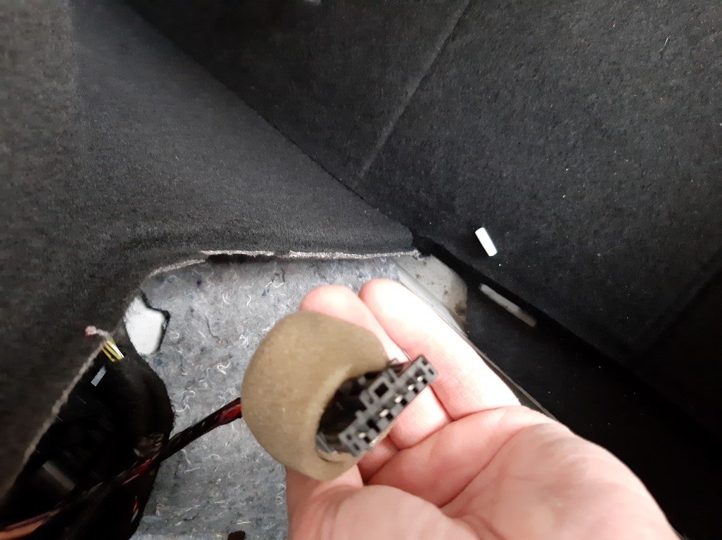

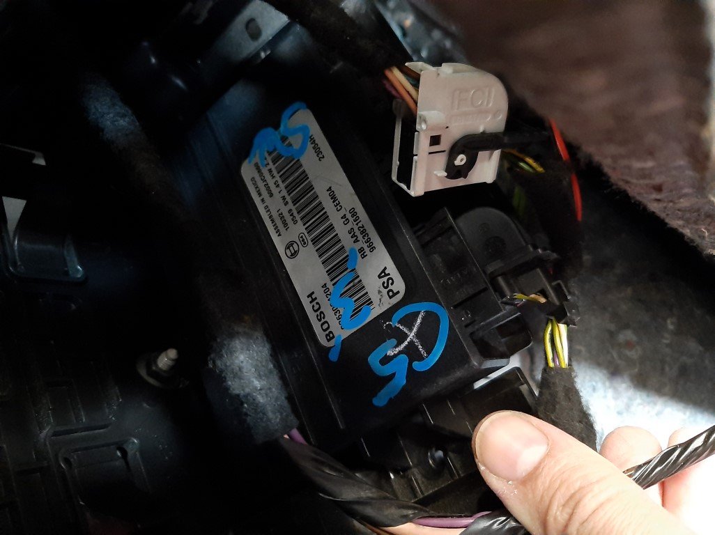

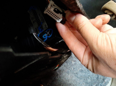

I bought the car 6 months ago. The front parking sensors don't work for me. I disassembled and saw that the ECU was for rear sensors only (no input for white connector). I also have some cable you can see in the picture. Can I buy a new ECU? What is this other cable for?
Thank you!
Thank you!

The parking assistance ECUs are different depending on options. You will also need the correct wiring harness - but you'll need to explain a little more about the car.
Are you saying it looks like the car has factory fitted front and rear sensors and the 2 sensors on the front wings for the parking space gap measurement?
If this is the case, it may be that a previous owner has replaced the parking assistance ECU with the wrong one.
What is the year of the C5, the trim level (VTR, VTR+ Exclusive), Saloon or Tourer, the VIN would be best.

So your car had front and rear assistance originally. That ECU in your picture is the wrong one.
If you want the correct part number, I'll need to look it up for you, but unfortunately PSA charge for this data now from 16th March 2020. Please see the info below - a Forum donation will cover you for up to 2 years for parts info etc.

Hi Stu - I've already confirmed he has OEM factory fitted front and rear so he should have everything already there - but the Parking Assistance ECU has obviously been replaced at some point - as the part number on the unit in his photo is not for this vehicle.
- x 2941
Re: Parking sensor in front of a 2009 C5 x7 tourer.
The blue ink marker scribble would suggest it's from a dismantler, so wrong choice?
- x 6955
Yes, wrong choice Eric.
