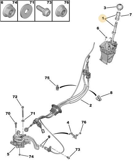

DISPATCH III LONG PANEL VAN H1 TYPE 12 2.0 HDi 130 FAP (DW10CD) Manual gearbox 6
The above is the parts diagram for your gearbox controls. As you can see item (7) - the sleeve is available separately. But this may help explain things better.

Do you have any more detail how to remove the item 1 (knob) Presumably Item 7 (Lift-Ring) would then slide off.

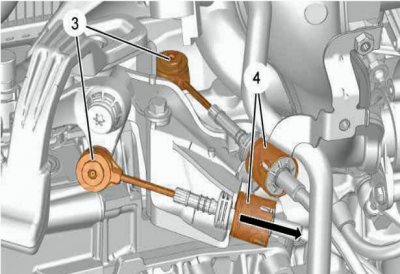

As promised. This is the procedure for removing the gearbox controls - but includes the reverse gear control device:walbeck wrote: 08 Nov 2019, 21:20 Thanks for that Mark

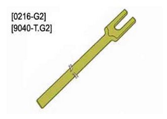

Recommended Tools:
| Ball Joint Extractor |
- Put the vehicle on a hoist.
- Place the gear lever in neutral.
- Remove the front right-hand wheel.
Remove:
| Uncouple the ball-joints (3) using ball joint extractor tool. Release the sleeve stops from their support:
Unclip the gear control cables retaining spacer on the body floor and push it towards the passenger compartment. Return the vehicle to its wheels. |

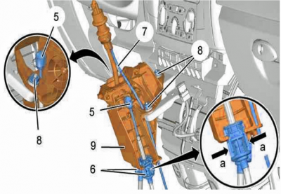

Remove the central console
| Uncouple the ball-joints (5) using a flat spanner. Unlock: The cable stops (6):

Marc sorry I typed in the wrong item number for the knob which i want to remove it should have been item 3 on the parts list you posted, I think the lift-ring 7 would then simply slide off, anyway that's what I'm hoping will happen There is a plate on the top of the knob which might conceal a fixing but I cant see any fixings on it? The plate looks as if its metal and has gear positions marked on it. I have seen other posts saying the Knob is removed by a anti-clockwise 1/4 turn but mine wont budge, don't want to cause any damage as the post didn't mention my model specifically
- x 6958
Re: Lift ring for reverse sticking 6 speed and reverse Dispatch
The gear level knob (3) just pulls off - but be warned - don't make the mistake many do and put your face over the gear stick as you try and pull it off - as they are extremely tight and when they come off you are likely to lose a few teeth - no kidding. Keep your face away and apply straight up pressure - there is no twist lock mentioned anywhere and my 6 speed box leather knob which I replaced came off straight away - it just pushes on and off.
Obviously the reverse gear lift off mechanism is covered in the procedure I posted, but the cable to it needs removing first.
