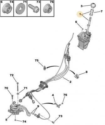

Ok, so now we know what you have:
DISPATCH III LONG PANEL VAN H1 TYPE 12 2.0 HDi 130 FAP (DW10CD) Manual gearbox 6
The above is the parts diagram for your gearbox controls. As you can see item (7) - the sleeve is available separately. But this may help explain things better.

Do you have any more detail how to remove the item 1 (knob) Presumably Item 7 (Lift-Ring) would then slide off.

Marc sorry I typed in the wrong item number for the knob which i want to remove it should have been item 3 on the parts list you posted, I think the lift-ring 7 would then simply slide off, anyway that's what I'm hoping will happen There is a plate on the top of the knob which might conceal a fixing but I cant see any fixings on it? The plate looks as if its metal and has gear positions marked on it. I have seen other posts saying the Knob is removed by a anti-clockwise 1/4 turn but mine wont budge, don't want to cause any damage as the post didn't mention my model specifically
x 6963
Re: Lift ring for reverse sticking 6 speed and reverse Dispatch
The gear level knob (3) just pulls off - but be warned - don't make the mistake many do and put your face over the gear stick as you try and pull it off - as they are extremely tight and when they come off you are likely to lose a few teeth - no kidding. Keep your face away and apply straight up pressure - there is no twist lock mentioned anywhere and my 6 speed box leather knob which I replaced came off straight away - it just pushes on and off.
