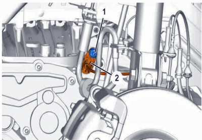

As promised. This is the procedure for removing the gearbox controls - but includes the reverse gear control device:
Recommended Tools:
Ball Joint Extractor
  • Put the vehicle on a hoist.
  • Place the gear lever in neutral.
  • Remove the front right-hand wheel.
Remove:
  • The fixing (1)
  • The reverse gear device (2)

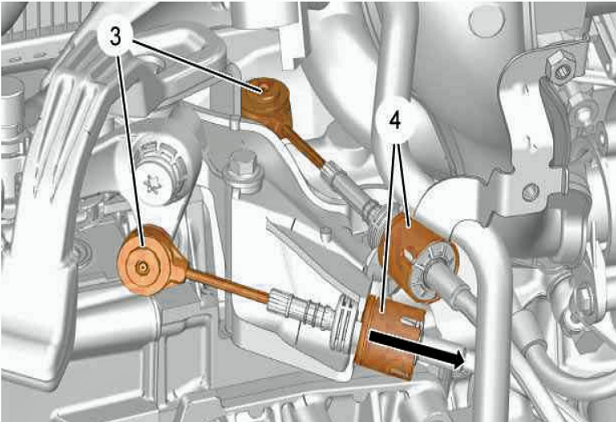

Uncouple the ball-joints (3) using ball joint extractor tool.
Release the sleeve stops from their support:
  • Push the locking keys (4) (In the direction of the arrow )
  • Detach the sleeve stop from its support (pull upwards)
Raise the vehicle.
Unclip the gear control cables retaining spacer on the body floor and push it towards the passenger compartment.
Return the vehicle to its wheels.
