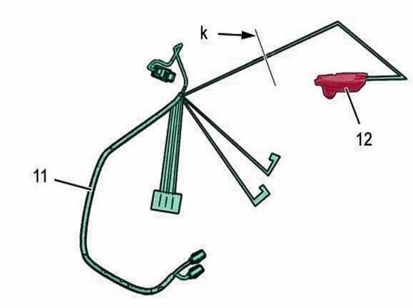

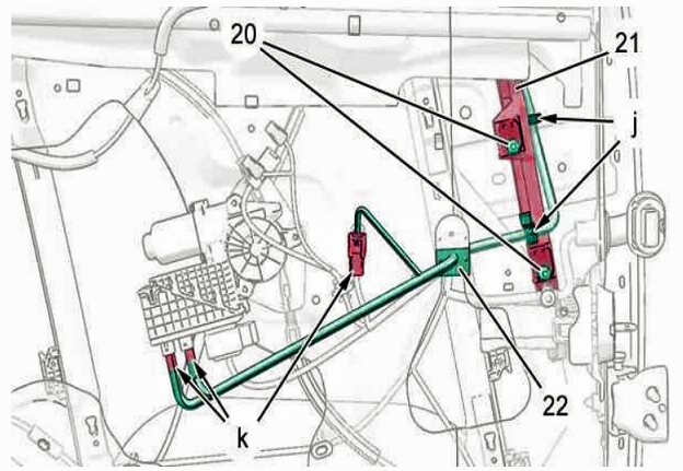

The external temperature sensor is a lot more involved as I thought. The mirror has to be removed, which involves taking the door card off and all the switches to get to the mirror mountings.
The temperature sensor is part of a wiring harness - no separate plug I'm afraid, so the new one has to be spliced to the harness when fitting.
I thought I'd advise you first, but if you still want to attempt it, let me know as It is a fair bit to post up.

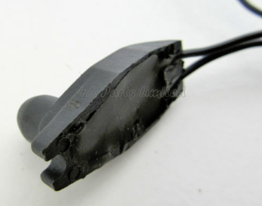

But this is what it should look like as you will know as you have the replacement already:
Now it must be on one of them as the nipple can always be seen from the underside - it's no good if the sensor doesn't protrude out of the casing or it won't be able to do its job.
So it is entirely possible it is on the left hand side for a right hand drive vehicle.... Double check the passenger side for a dimple.

Yes that's what the replacement part looks like and I can confirm the "nipple" protrudes from below the offside driver's mirror.

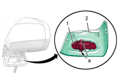

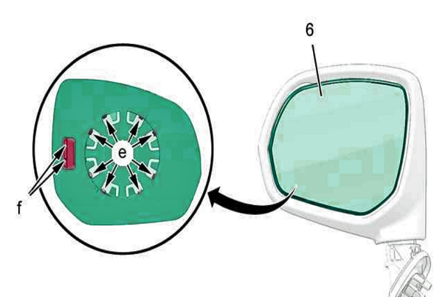

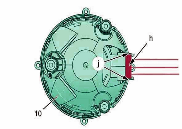

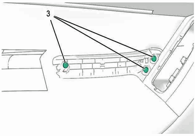

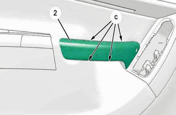

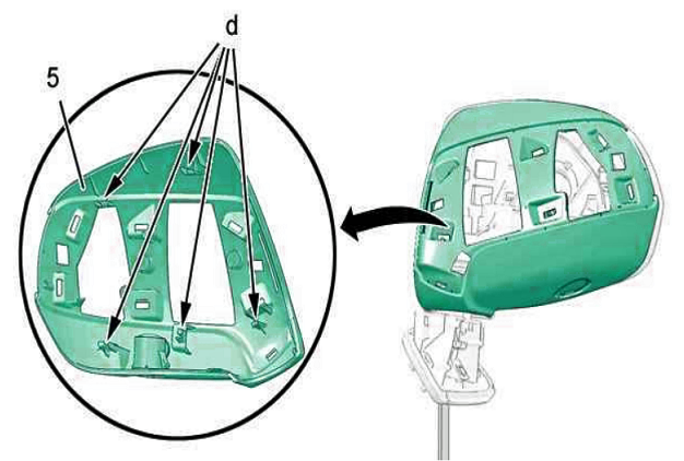

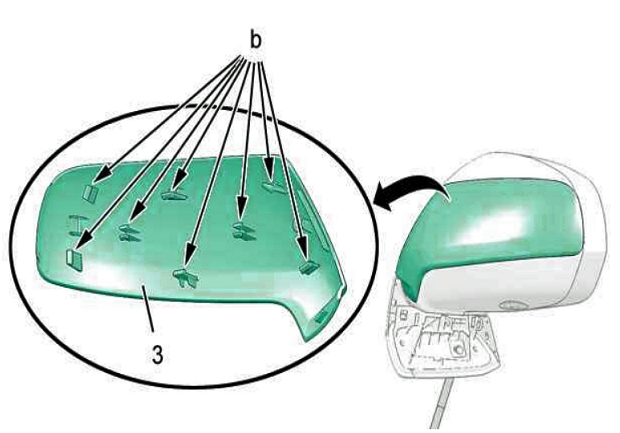

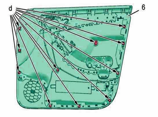

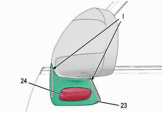

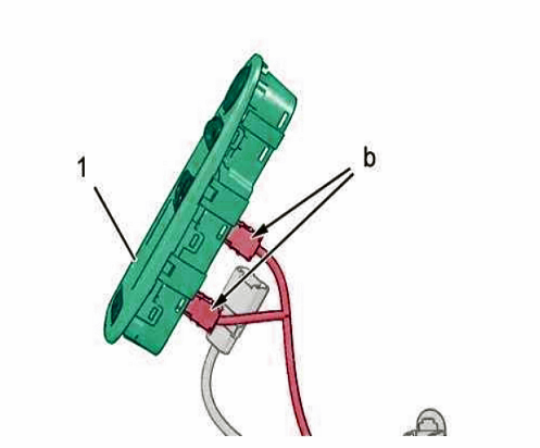

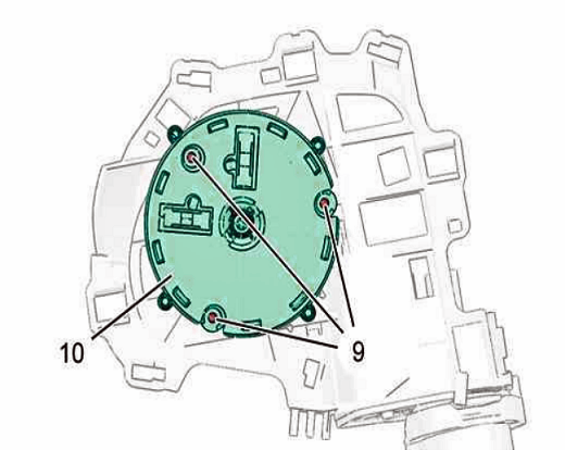

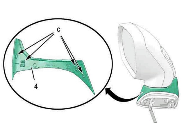

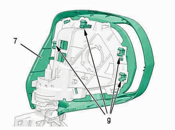

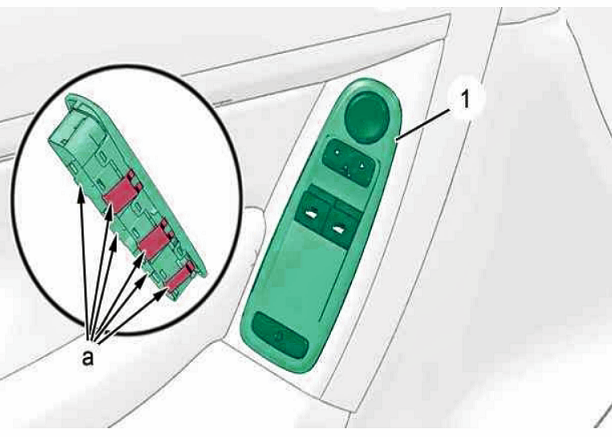

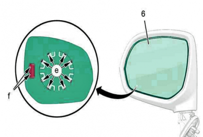

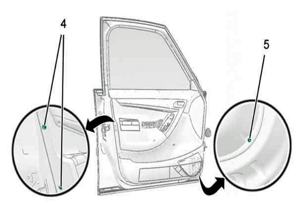

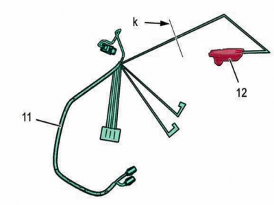

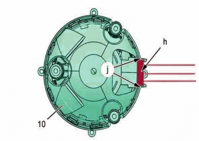

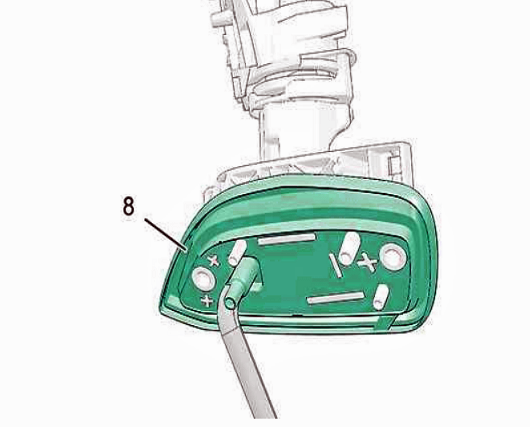

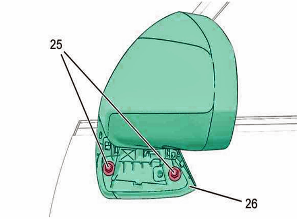

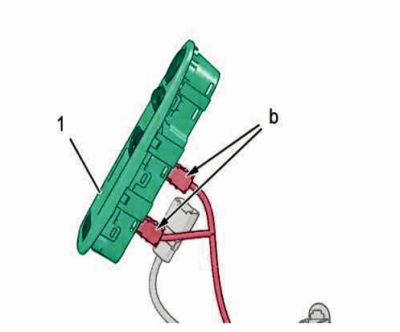

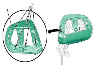

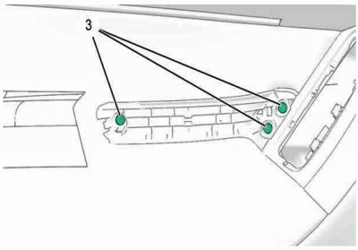

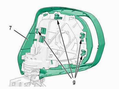

Here's the guide - which contains some extracts from the door disassembly to get the mirror off - I believe I've excluded any non-relevant operations from that - but if you get stuck let me know.
Electric Window Switch Assembly
Door Trim Pad
Exterior Mirror Remove:
Remove:
- Posts: 8
- Joined: 21 Jan 2019, 20:28
- Location: Rochester,Kent
- My Cars: C4 Picasso VTR+ EGS HDI 110, Xsara Picasso, Xanthia 19TD, Bxs X 2
Re: C4 Picasso outside temperature sensor
Thank you very much for the very impressive illustrated strip down guide much appreciated.
When we have a break in the snow and the temperature goes up a bit I will tackle the job and keep you informed.

I finally had some spare time yesterday so got around to dismantling the o/s mirror to replace the sensor.
Following the illustrated guide you supplied the rear exterior shell (item 5) was removed carefully and bingo ! the sensor was there to remove.
Fitted replacement unit using solder type butt connectors which are already heat shrink wrapped there is plenty of room in the mirror shell I just shortened the new cable by a couple of centimetres.
But sad to report still no temperature readings.
The whole job including putting away tools, extension lead ,hot air gun etc. only took about 45 minutes because I only had to remove the rear shell of the mirror not the glass or motor etc.
Once again many thanks and I will update you when the job is tackled again.
