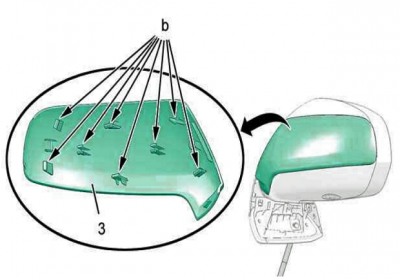

Here's the guide - which contains some extracts from the door disassembly to get the mirror off - I believe I've excluded any non-relevant operations from that - but if you get stuck let me know.

Thank you very much for the very impressive illustrated strip down guide much appreciated.

I finally had some spare time yesterday so got around to dismantling the o/s mirror to replace the sensor.
Following the illustrated guide you supplied the rear exterior shell (item 5) was removed carefully and bingo ! the sensor was there to remove.
Fitted replacement unit using solder type butt connectors which are already heat shrink wrapped there is plenty of room in the mirror shell I just shortened the new cable by a couple of centimetres.
