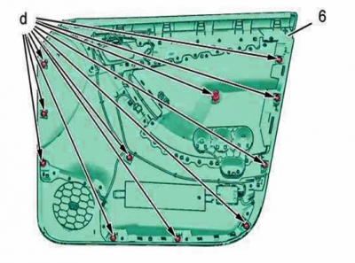

  • Remove the screws (4) and (5).
  • Unclip the door trim pad (6) (at "d").
  • Remove the door trim pad (6).

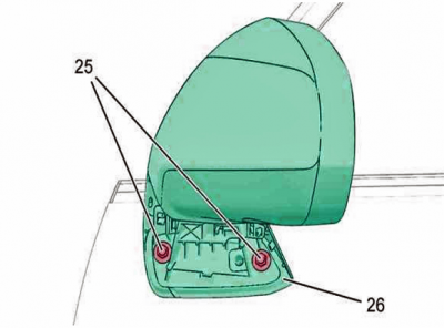

Remove:
  • The bolts (25)
  • The exterior mirror (26)

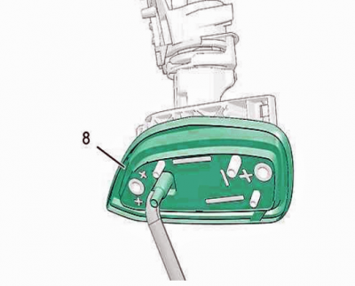

  • Detach the front exterior shell (7) (at "g").
  • Remove the front exterior shell (7).
  • Disengage and remove the base seal (8).
