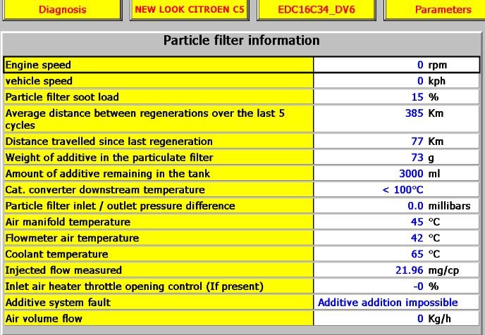

There's no need to read a cold exhaust temperature so the lower limit probably starts at just under 100, hence the 98 when cold.

Mine (different engine/ecu) shows <100c from cold.

On my engine, it reads 98 degrees C until the temperature rises above that. So after a drive to warm everything it reads correctly but from cold it reads 98.
It is not a fault.
