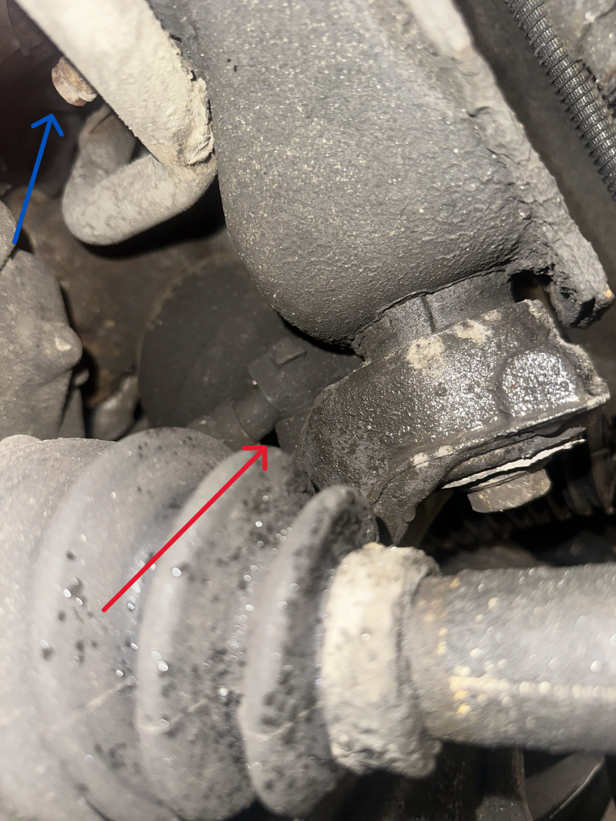

Hiya, sorry you're still finding these problems. I've had similar apart from the stiff suspension. Not sure if this will help with the vibration but I was getting a vibration similar to yours in the weeks after rebuilding the steering rack and this week I checked the lower torque stay where it meets the subframe and found that although the bolt was 'tight' there was looseness found at the bushing. I found that I could continue to tighten the bolt until the looseness went away. It was barely perceived.
It's likely I did not tighten this to the correct torque because I didn't know the value. And you can't get a torque wrench in there anyway. Cut to the end: the vibration has ceased and I I'm certain this was the reason. Just sharing what I found this week.

@aerodynamica
Do you mean this bolt is not tightened enough? Is it necessary to remove the subframe again in order to be checked? Thanks!

Re: Stiff suspension after spheres regassing - C5 X7
Unread post by aerodynamica »
Hi, yes that bolt. However that picture is a different model to mine. On mine the bolt is horizontal, across. The larger rubber silentblock is on the lower casting of the engine (possibly part of the driveshaft support bearing).
If yours is like the photo then likely this bolt was not loosened. Instead perhaps the one at the other end of the torque stay.

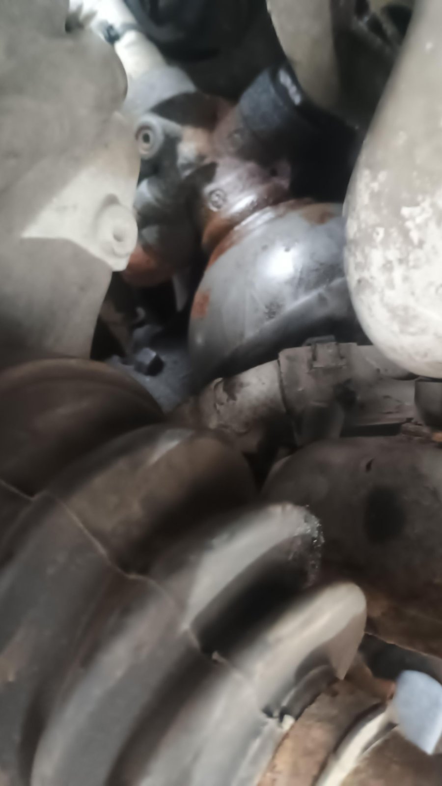

Kees wrote: 25 Apr 2024, 07:09 It's not difficult to remove the front stiffness sphere!
You need to remove the left drive shaft and beneath the subframe the 6mm bolt with hold the airco tube.
And then with a long chisel you can hammer it loose.
I did this already a few times with different car's
Greetings,
Kees.
Hi Kees,
I'm planning on doing this on my C5 2.2 2014 Tourer. Just wondering where the 6mm bolt holding the aircon is located? Is it the red one i'm pointing at in picture or is it somewhere else further down?
Cheers
Unread post by Kees »
No, when you follow the tube from the front on the left side, you find the place where it is mounted by this bolt on the subframe.
