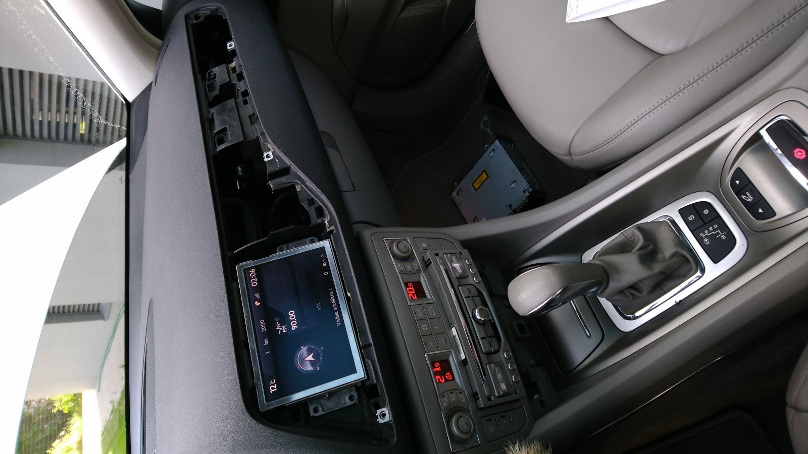

Got the fascia off pretty easily, but then came the next learning: car radio release keys. RNEG MyWay is a Becker, so needs a set of those flat ones, which I of course did not have. Buying a set like this tomorrow:

Learning: buying the whole 20pc kit proved useful (15€). Multiple types of standalone keys are labeled Becker and only one set worked perfectly on the RNEG. Push the Becker keys all the way in and it unlocks, no need to twist and turn anything.
Kit also had nice angled ones for RNEG2 (rightmost on the red bag picture). Straight design got stuck in the holes.

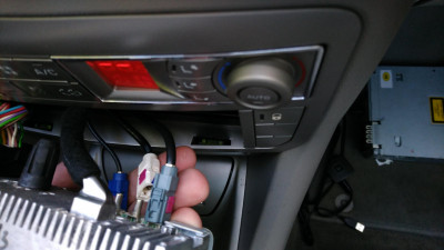

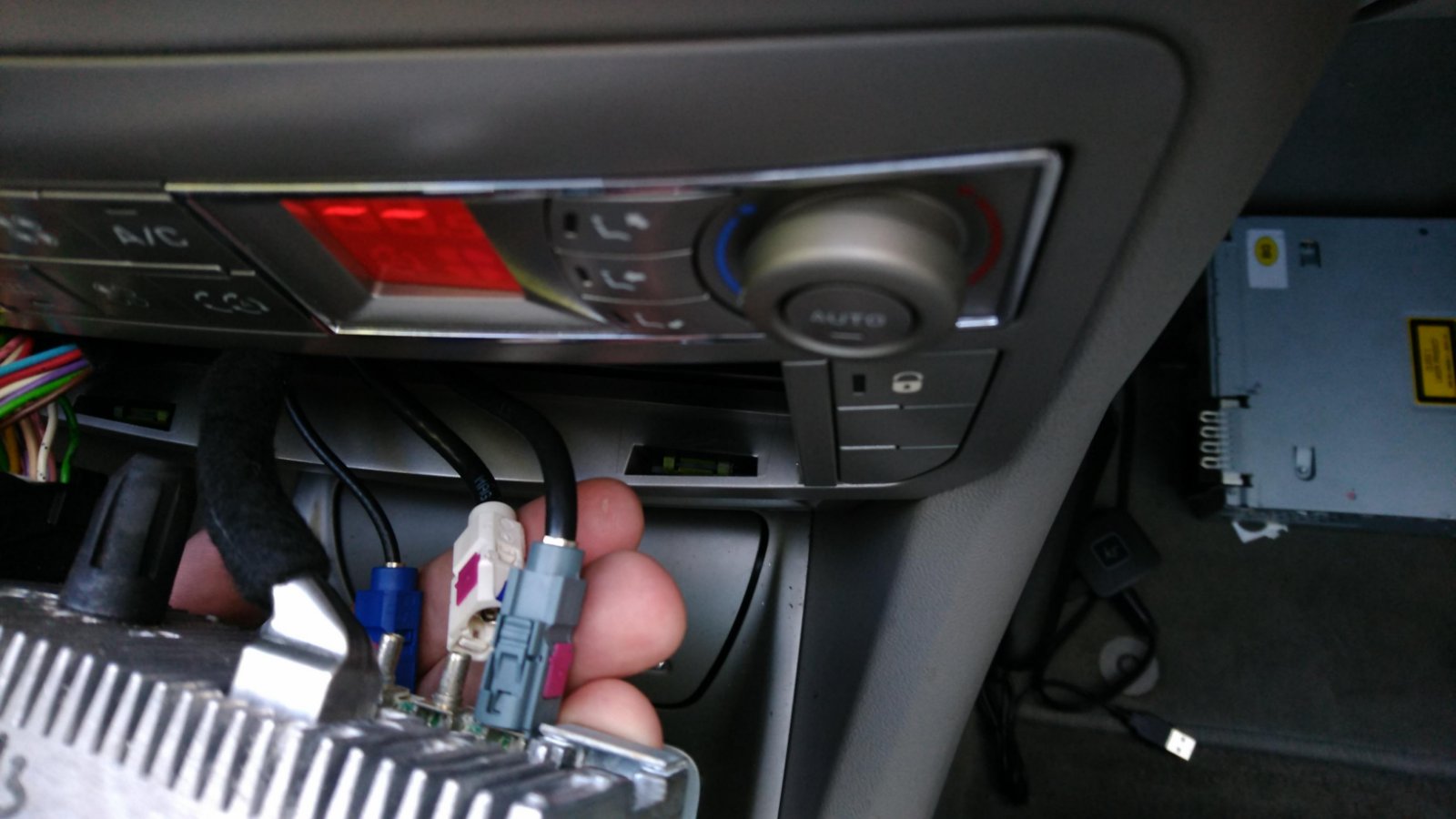

* satnav doesn't work "0 satellites found" message - wiring seems to be connected correctly, FM radio works perfectly (even w/ just grey connected). Any ideas? See pic below. Only grey antenna connector is nicely housed for some reason on this unit. Previous RNEG had all 3 connectors housed. EDIT I sent my ebay seller a complaint about the the dysfunction + naked connectors, we'll see what he comes up with for a reply.
* BT phonebook download seems to fail vs my SailfishX phone (we'll try wife's iPhone later)
INSTALL
INSTALL
SATNAV CONNECTIONS
SATNAV CONNECTIONS

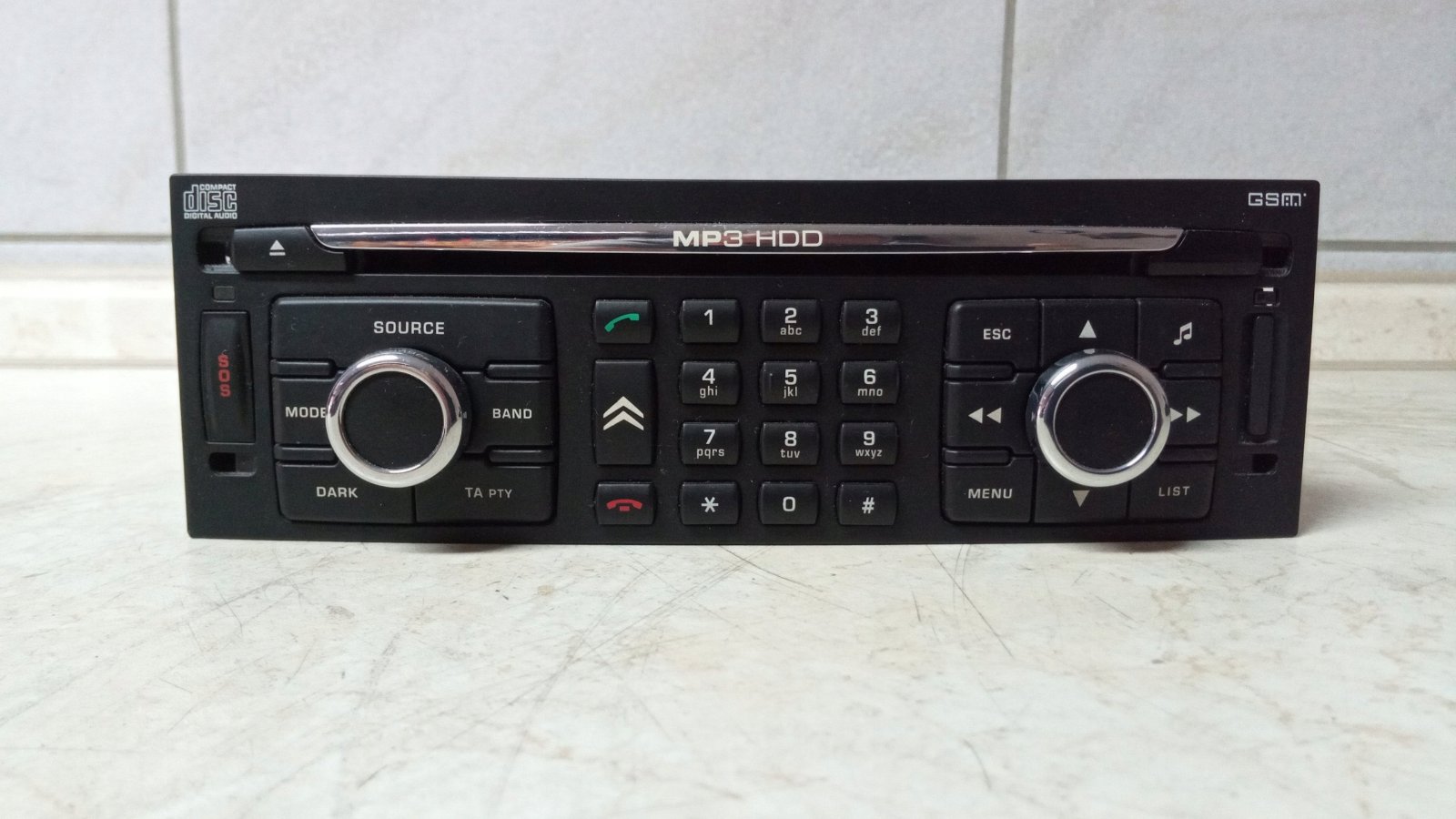

I'm thinking about version with hard drive(pic attached).
It will work, or i need change dispaly too to have radio with usb?
x 6956
Re: C5 X7 2-in-1 navigation tutorial
You should be OK if fitting the RT4 (as in your picture), but you will need the High Res Screen for the NG4 (Navidrive 3D) or RT6 (no hard drive on RT6). The RT4 should work with both screen types, but the high-res screens are hard to find and also need a slightly larger fascia panel on the C5 X7.
