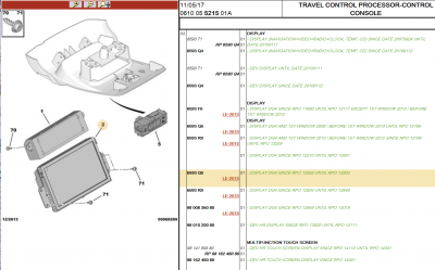

None of those are C5 X7 screen part numbers I'm afraid. You're probably looking at another vehicle....
Available screens for the X7:
Click to Zoom Note LE-2013 options have now also been replaced with 9804707380.

GiveMeABreak wrote: ↑07 Jun 2018, 16:41 None of those are C5 X7 screen part numbers I'm afraid. You're probably looking at another vehicle....
Yikes, I missed specifying that I was replying to "finding the bigger screen opening dashboard panel" problem. Made the edit now.

That makes more sense!

Thanks, ^^^^ is exactly right and also confirms what I thought I saw. My service.citroen.com view seems to be somewhat less detailed, or maybe I don't know how to use that website yet (it is literally the worst website UX I've seen in years, lol).
My ebay screen supplier happened to "miss" sending me the screen-unit connection cable(s). After some ebay messaging, he agreed to send them over. But just in case, Marc what's your take on what the cable(s) part number(s) should be?
Is it just 6574KZ that's required to connect RT6 to DG4?
