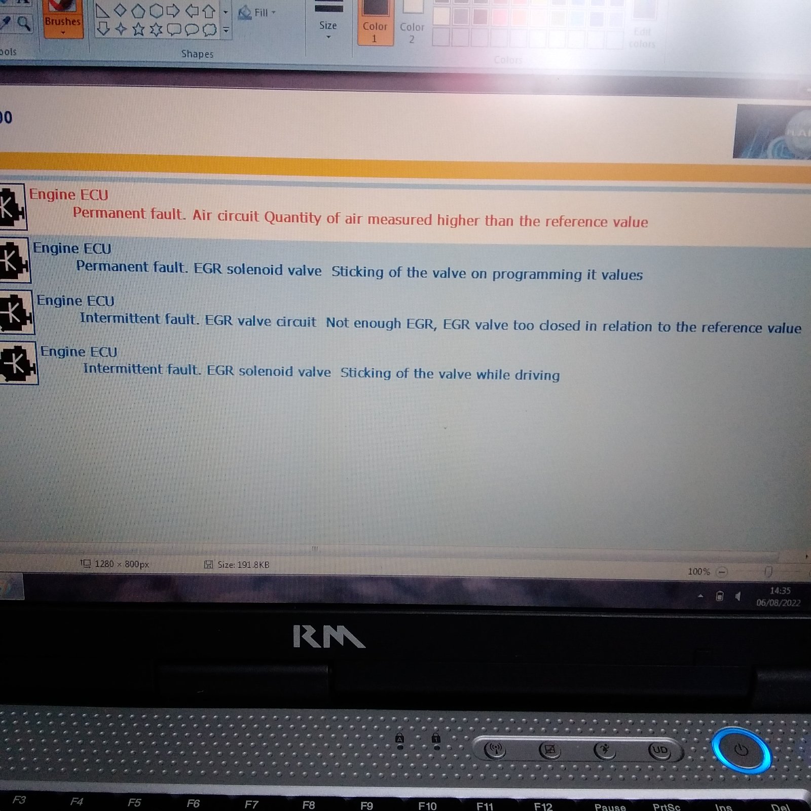

Win7 pro 32bit now up and running now ive got this
Diagbox is 7.2, ive still got the rest of the updates to install i think my interface is 7.5 is this the reason for the screen shot.

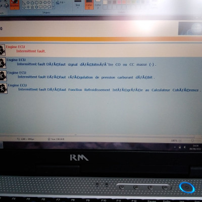

Found a large hole in the air box where its been hitting the egr valve solenoid, holes sorted , new egr valve on today the screen shots where before both jobs were done, the bottom screen shot ? Was my 307.. jabberings of a none earth like lingo !
