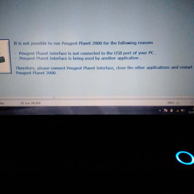

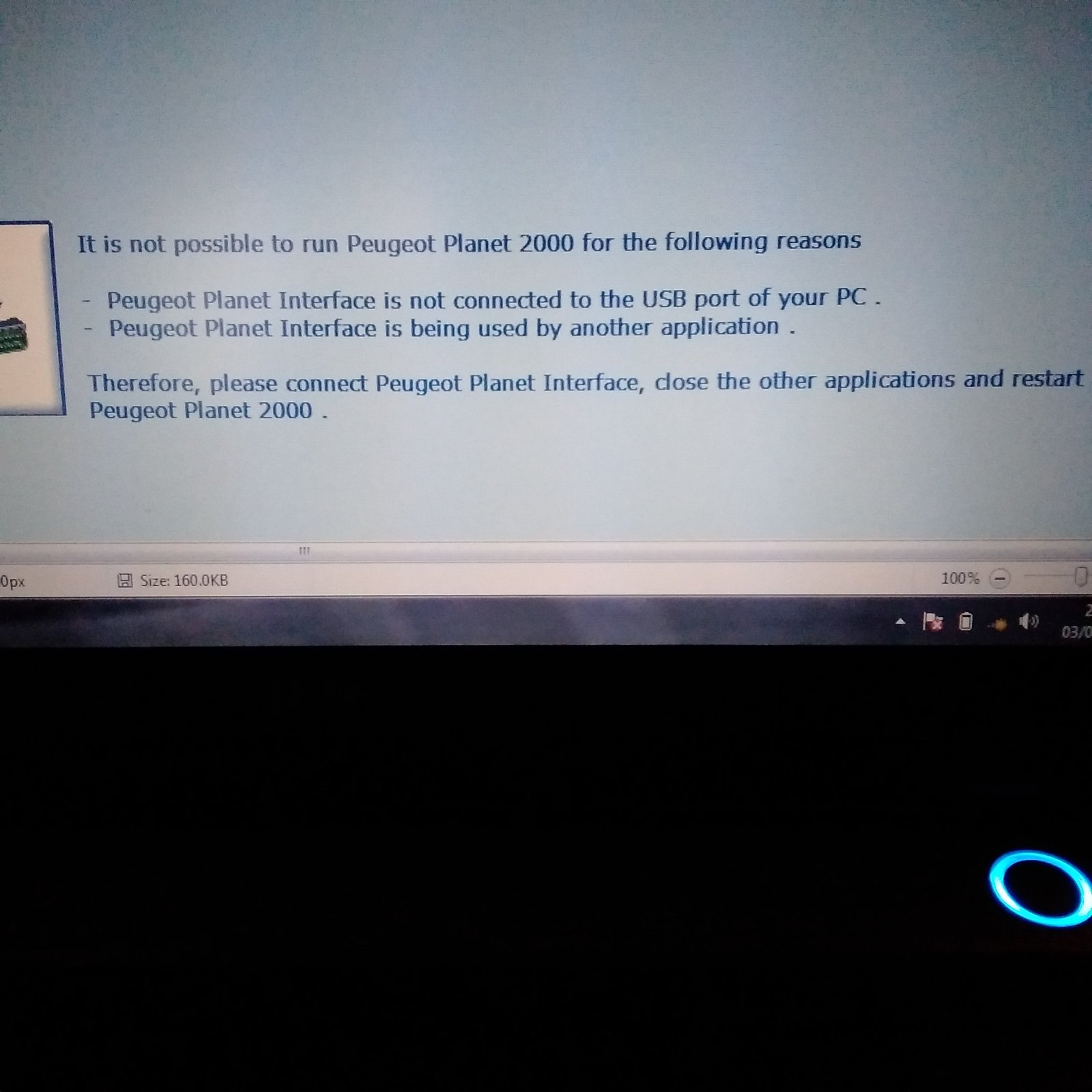

Win7 pro 32bit now up and running now ive got this
Diagbox is 7.2, ive still got the rest of the updates to install i think my interface is 7.5 is this the reason for the screen shot.

Re: Lexie installation problems
Sometimes it helps to plug the equipment into each of the USB ports, so the software can find it whichever port it is connected to. You might want to do this after each successful upgrade.
DON'T FORGET TO BACKUP THAT FILE!!!

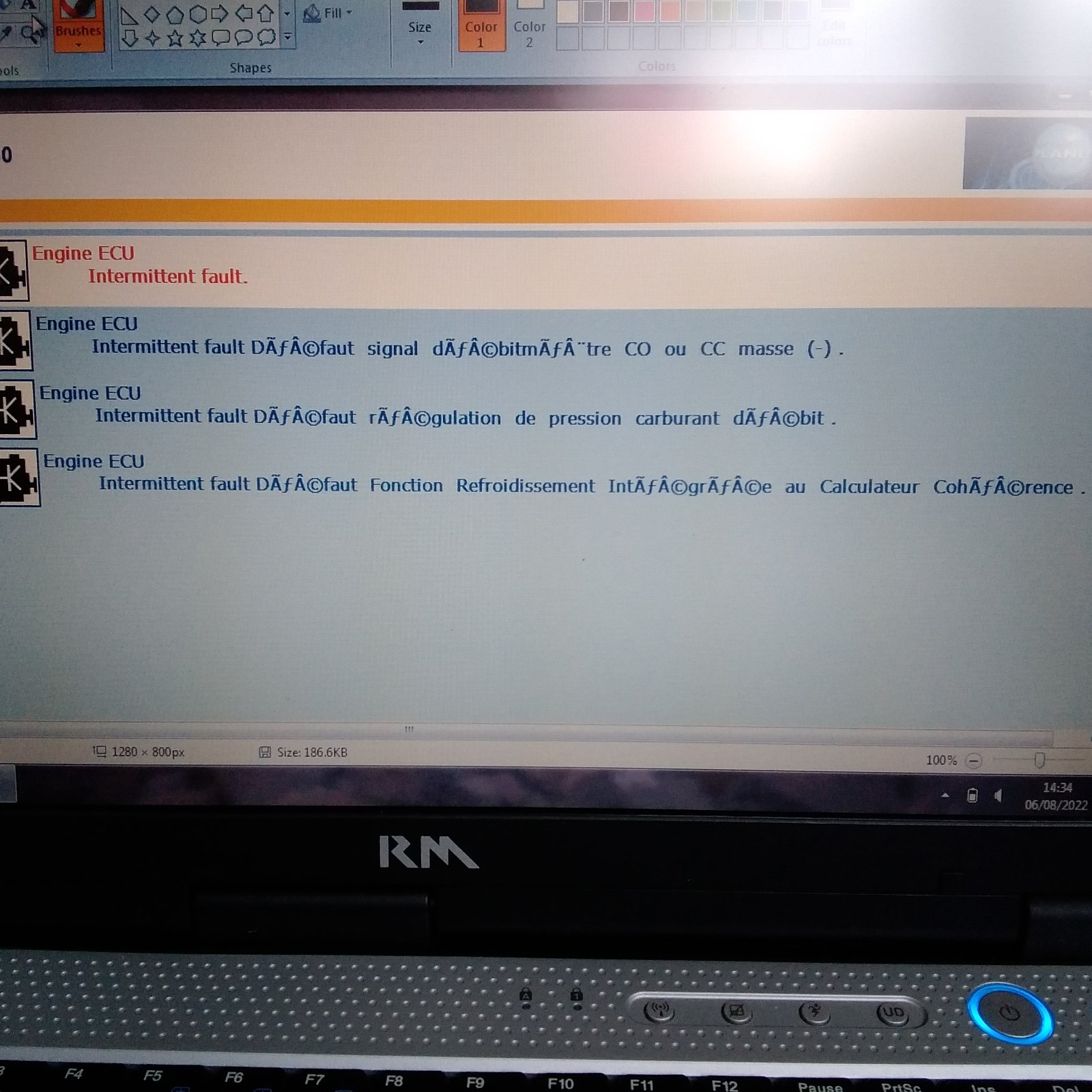

Found a large hole in the air box where its been hitting the egr valve solenoid, holes sorted , new egr valve on today the screen shots where before both jobs were done, the bottom screen shot ? Was my 307.. jabberings of a none earth like lingo !
