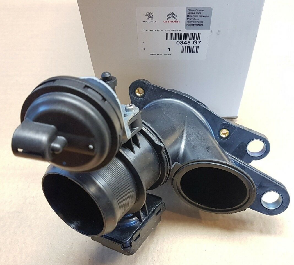

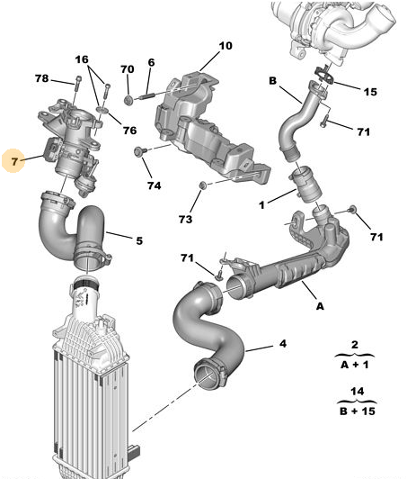

The Air Doser for your vehicle is item (7):
It is part number: 0345G7 and costs £332.81 (UK Sterling) so 45,464.29 Serbian Dinar.
But at least with this part number you can search for the correct one. Be warned though, some aftermarket - non-originals may be different, so stick to a Citroen one if possible.

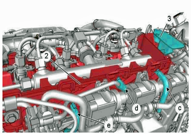

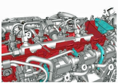

Here's the supply: (Don't forget to check the filter at (3) as these can become clogged up).
(2) Air inlet manifold with integral vacuum reserve.
(3) Breather and filter for all the control electrovalves.
"c" Outlet towards the proportional electrovalves controlling the double mixer.
"d" Pressure drop inlet for the vacuum pump.
"e" Outlet to electrovalves :
Proportional electrovalve controlling the variable resistance turbocharger
Control electrovalve for the EGR heat exchanger by-pass

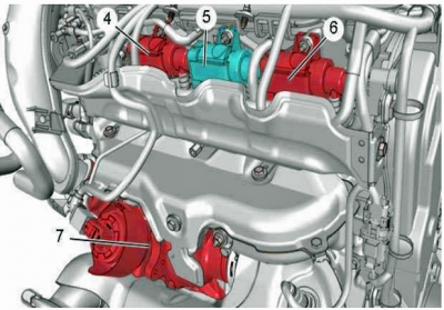

Here's the electrovalves:
(4) Proportional electrovalve controlling the variable resistance turbocharger.
(5) Cold air circuit electrovalve.
(6) Hot air circuit electrovalve.
(7) Variable geometry turbocharger.
