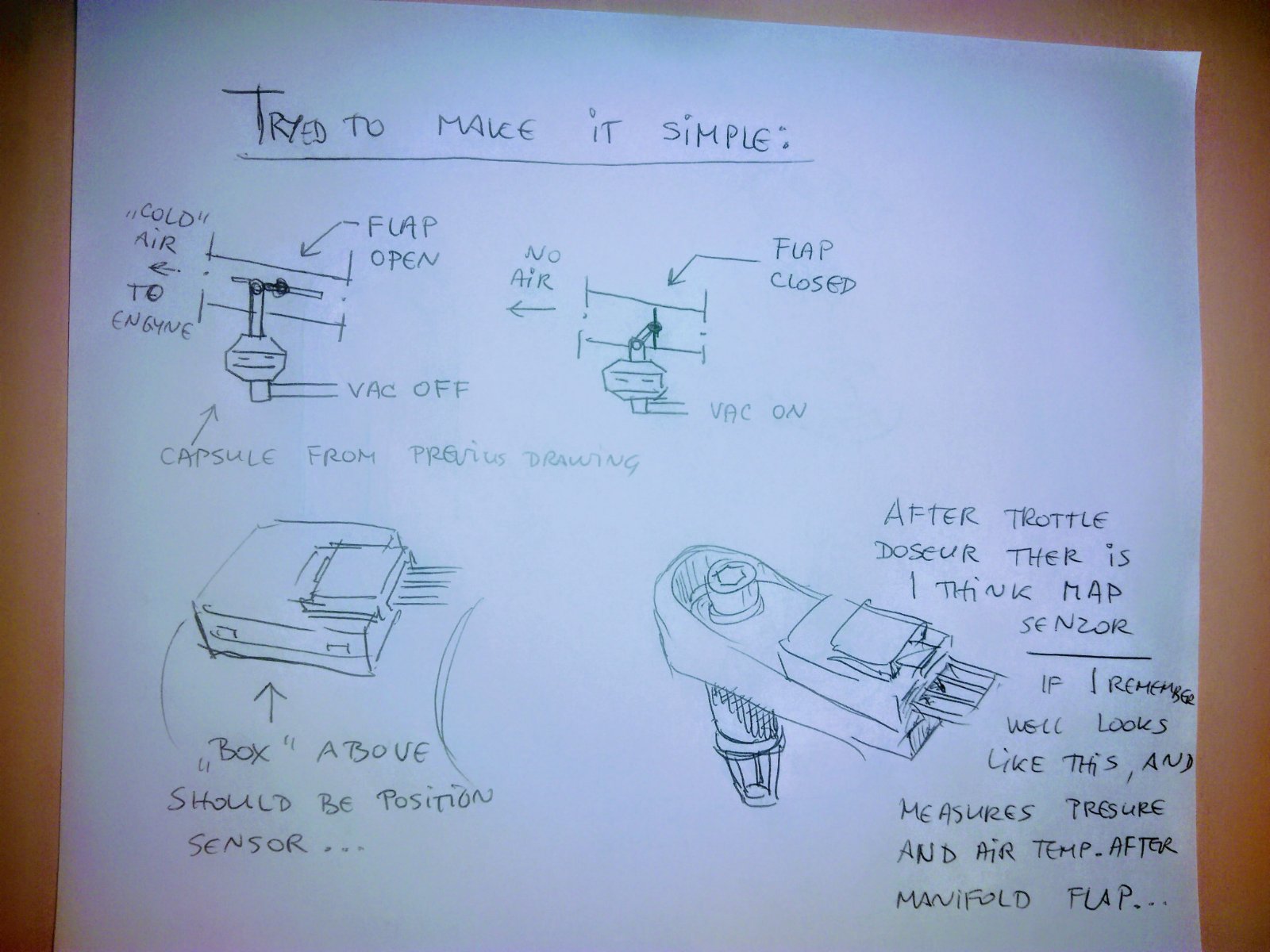

my drawing...
my drawing...
* New experience said that only rod, inside the capsule can be rotated. So there is no need to rotate entire capsule (this can create problems with vac tube distance and position)... only rod, connected to the rubber membrane, probably above some internal spring, can be rotated for 180 degrees).

Sorry, I didn't and still don't recognise the picture. Yours with age of your car will be different to mine, the principle remains the same. The double doser allows the intake system to bypass the intercooler.
Pete

This is the capsule that with vacuum moves flap inside doseur. There's no springs inside...rubber on this capsule, holds flap open, and vacuum close it when Ecu wants... no need for double doseur, because single one done good job last 3 years since I own the car. Someone mentioned motor - that's above flap, black box should be position sensor. By my conclusion, flap movement is done only by this capsule. Wery simple method... Only maybe I will change rod with some DIY peace of plastic...
Another problem is, that I today, during check , moved one vac tube on the vac pump, and cracked connector... in lack of other tubes, reconnected it with peace of heat shrink tube, and duck electrical tape... all working, but I need to find some good peace of tube. Does someone knows for what is used first vac tube, toward You, when looking to engine, at asume vacuum pump, on right side of engine?
